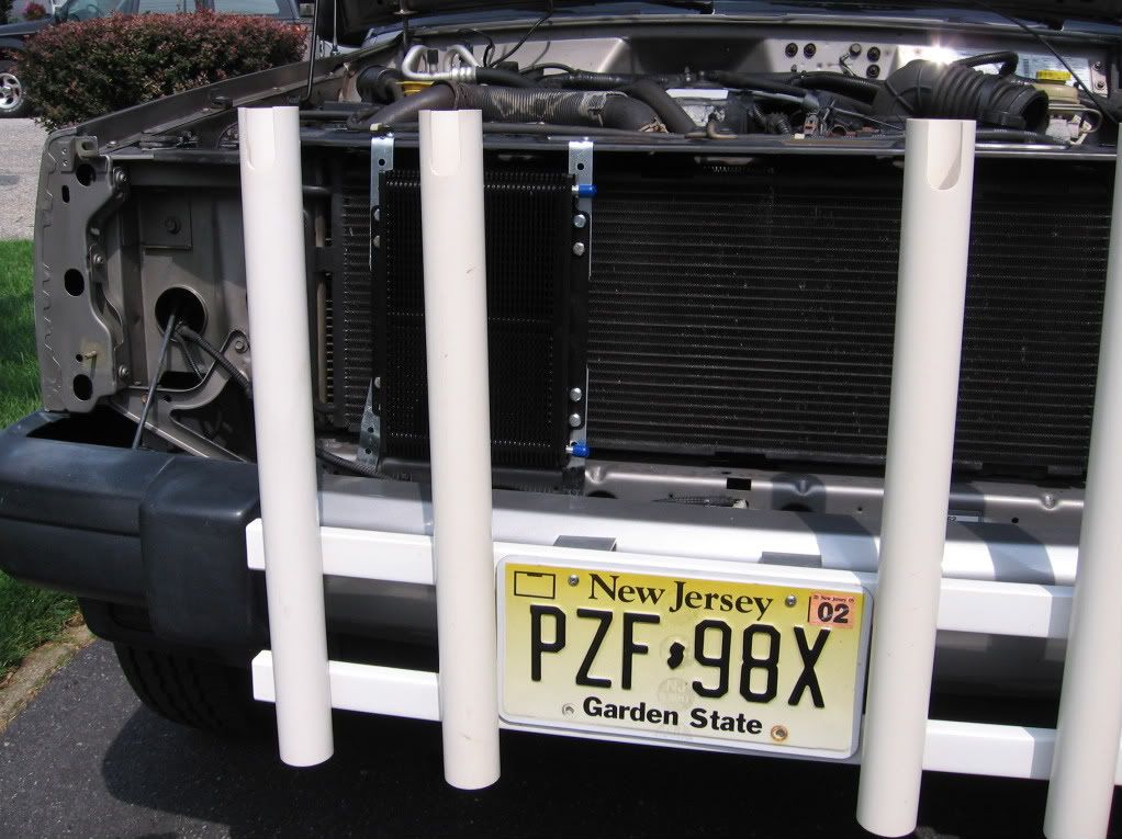

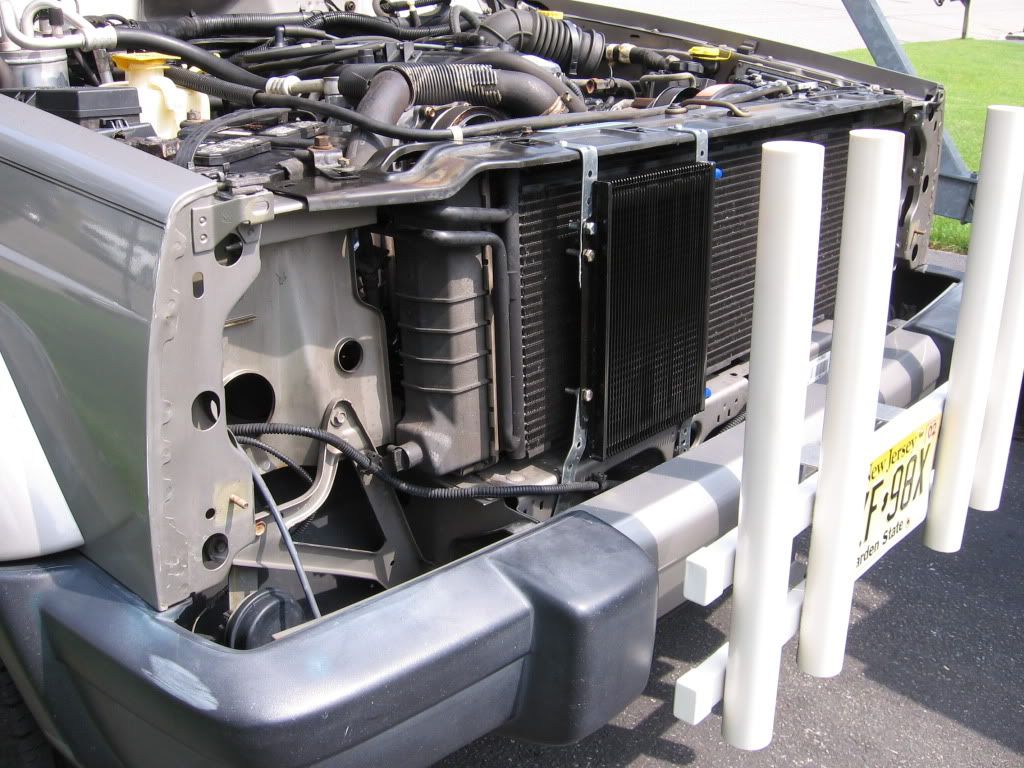

I did the 70268, and guage. AW4 is a good auto, but it heat control is a definite high priority issue. I don't know about the older model years, but I think they all have under engineered engine cooling system issues as well.
heres mine:

Great job on that mount! That's way better than cramming an ice pick between the fins like I did!
