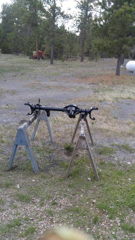

The Axle
It's OUT of the jeep... I need a name for this guy who 'worked' on it that is forum friendly.. Dipwad will work till I, Or you, come up with a better one.
I pulled the drive shaft and the end U joint was hatched NBD...... Till I turned the Pinion.. Loose AND a BAD feeling with 0 preload and wobbles.. Dipwad had changed the pinion seal I figured the ring was toasted, once inside behind half a tube of silicone I find the carrier loose though the shims are still there behind the bearings... (OEM) and the bearing cages beat up and Dip wad put in new seals with the other half of the tube of silicone. I have 0 hope he put in the Bearing caps the same way as he found them but I really don't know HOW they should go because every time I have pulled them I kept them carefully set up to put them back the same way. I did take a pict but I consider that rather meaning less now
He also beat up the inner edges of the bearing housing installing the seals but not where the races sit farther in. I'll pull the Pinion today as I could not find my yoke holder last night. There were fine ground metals in the oil....... gotta be from the pinion bearings. The pinion looks OK as does the ring.. shockingly. will know better once out.

This is where I am at now minus the axle on the 2000 XJ

Progress,
Stripped, scraped, wire wheel and Pressure Washed to the nth degree, then painted, waiting on parts.
Way more than planed for on this.
