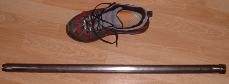

It's the same size as your front hub axle nut. 36 MM. 'matter of fact, when people make their own adjusters, they commonly use old axle nuts. If you're making one, do yourself a HUGE favor and make 2. They are SO much easier to adjust when you don't have to pull it out of one side and stick it in the other for each adjustment.

I can second the 36mm size. See here - diff tool C-4164 for 8.25 axle carrier bearings - JeepForum.com
I only made one as for the little extra work it means during set up is hardly a major head ache when I might never need the tools again.
