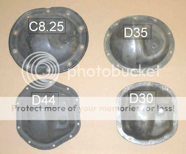

This may be lame as hell, but I keep a picture on my cell phone of all dif covers for quick reference in the you-pull-it yards.

These are what came stock on an XJ ever. Take 1 minute to look at this pic and then you are set for life on IDing XJ axles.
