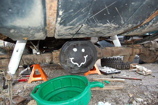

Yep, new axle in. With 96 ZJ disc brakes, and the parking brake lever modded to take stock XJ cables. Ive only got one cable in, waiting on the other to come in the mail, advance only had one). Has a lubelocker gasket... we will see how that holds up after a few fluid swaps.
Installed my rough country extended rear lines while I was at it, install of those things was easy, and they are pretty nice quality and braided, so it should help just a bit more with stopping power.
Also swapped out the fluid in the transfer case... it was black. Ugg. Made quick work with a suction gun that holds about 1/2 quart a go, and filled it up till it ran out the top with basic dextron. Going to do the front diff to, but it got to snowing a bit more than I expected.

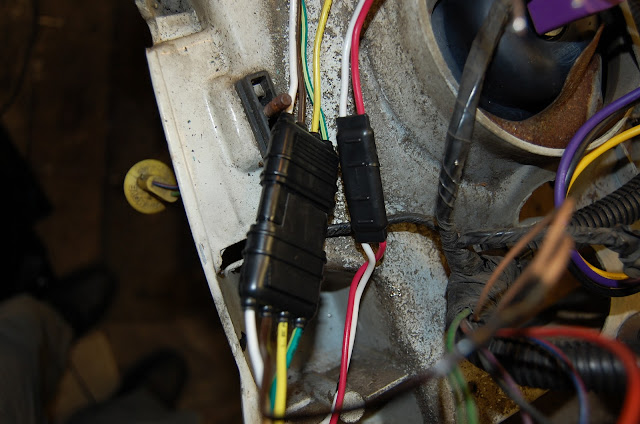

Just as an add in, I replaced the front lights and harness some time ago. This is what I started with:
And this is what replaced it:
And
I am not worried about running these connectors because the headlight wires are now only activating the relays for the new harness. The turn signals would feed though the same connectors on a trailer, so it will work and has been working, not getting hot or anything. Getting clean wire was hard, that corrosion went all the way back some 8 or 10 inches, and in some cases, I just wicked as much solder and flux in as possible. Stiffened those wires up, but gave me a better connection. Some day, it will need replaced, but this will work for a season or 3, with how much dielectric grease in in all of it.
I also upgraded the harness a bit and soldered the crimped connections. It was made to a price point.

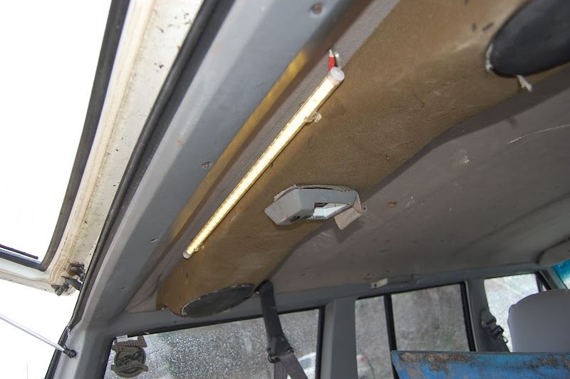

May brave teh storm and wire up the pile of LEDs I got here.... The yellow strips are going inside the turn signal housings, and the red bars are going in the center taillight housing. the white bars will be going in my front dome light, under the hood on both jeeps... too dark right now, and these are rated to handle the weather and the heat.

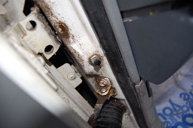

Since I have no funds at the moment to pick up wire, I grabbed some sheet steel laying around, and some snips, and pulled my seats. Found there is a lot of fiberglass down there, and found 6 good sized holes.
I'll do a quick patch on them at the moment.
The good... The firewall portion looks to be good clean original painted metal.
The bad... everything else, and there are a few holes into the rocker panels. So its getting new rockers and guards this spring and summer.
