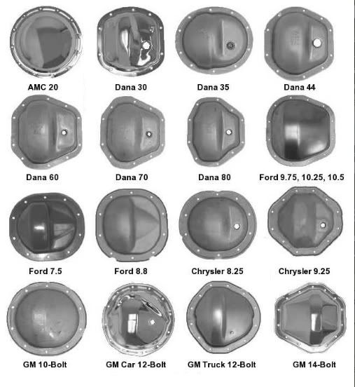

I have a 1991 Jeep Comanche Pioneer, 120" wheel base. The rear-end is toast, and finding a new one has been a bear...it has a DANA 35 with 3.55 ratio, and the only thing I can find to fit my budget is a D 34 3.55. are they interchangeable?

Oops it's the one with the hexagon instead of he round cover...

Yes, the D35 and D44 are interchangable, provided that both are from a Comanche.

A d35 was a bear to find, and the guy I got this one from us a body man who has a junkyard. He guaranteed this one to work, or he would replace it...it doesn't look anything like the one posted on this thread, so I don't know what the heck it is!

that rubber plug gives it away, chrysler 8 1/4 diff, better than a 35 but not a 44...
cherokee axle can be fitted with some work...axle perchs shock brackets
