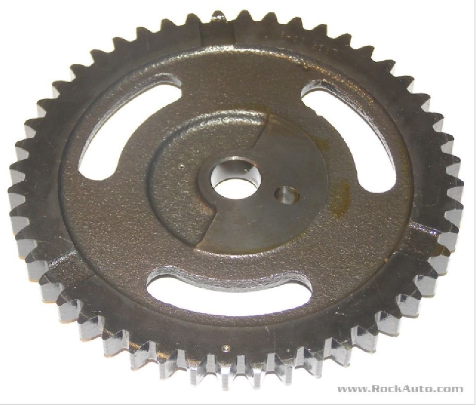

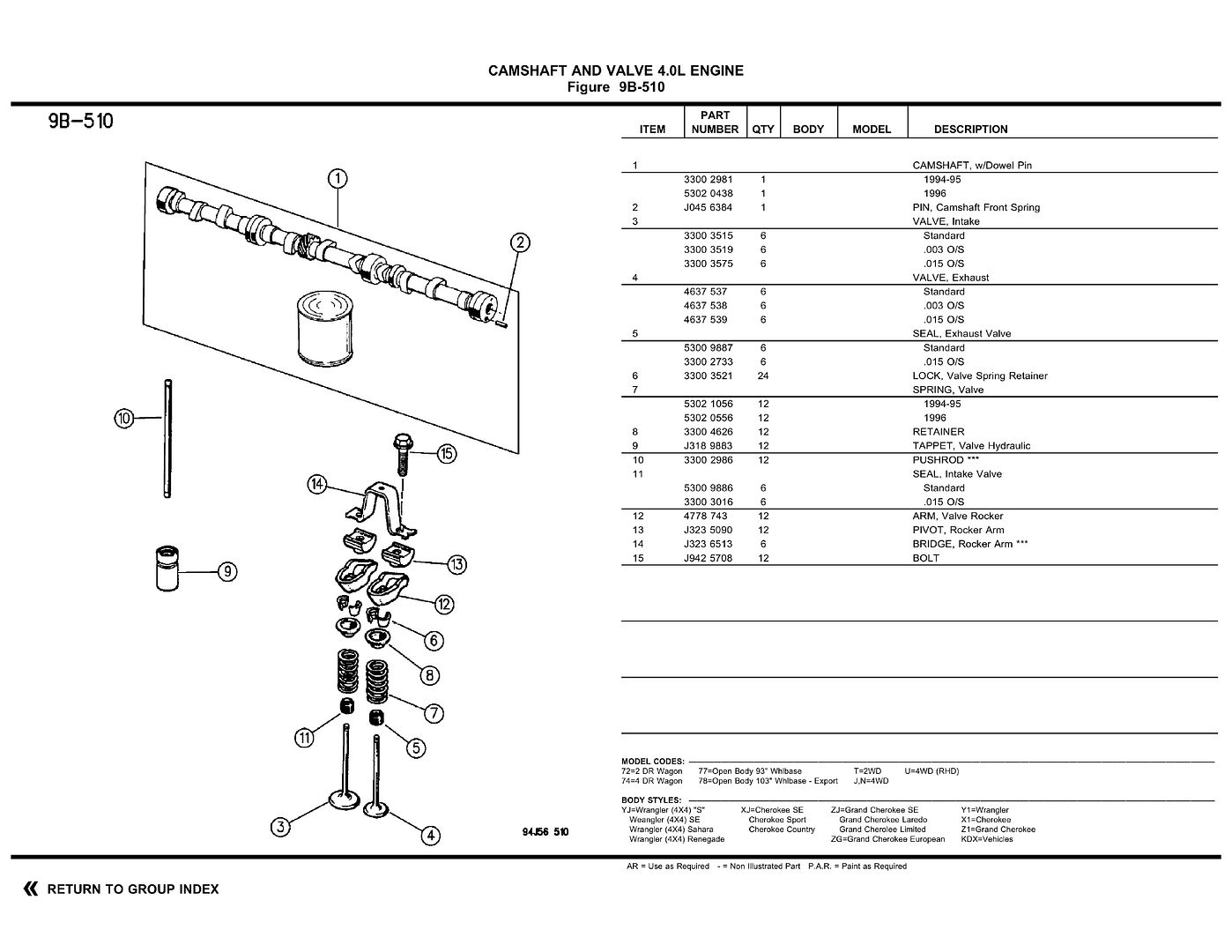

Your camshaft sprocket pin may be sheared. Not that long ago a thread was posted that showed the pin sheared.
Cam sprocket pin (88-96 a roll pin, 97-98 a dowel, discontinued in '99) - Item #2.
Cam chain sprocket showing the hole that the pin goes in to.
