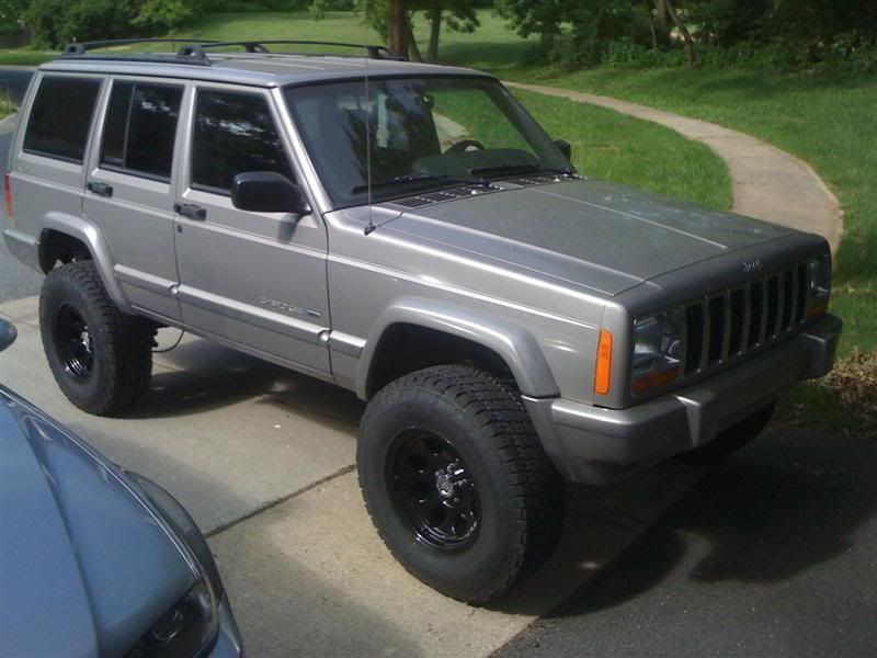

I am running 15x8 4.75 bs w/ 33 12.5's. I had to put 2 washers under the steering stop bolts to stop the rubbing in the lca and the tires just barely stick out past the flares in the front. At full flex they tuck in pretty good still also. I went with the 4.75 bs so I could keep my stock flares and not have half the tires sticking out from under them. The more bs you run, the longer your hub bearings will last also.
