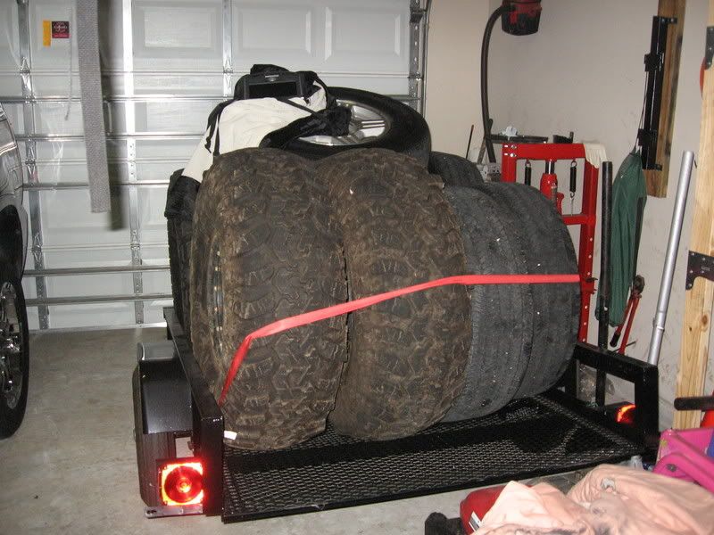

I bought this 5X8 at Lowes. I bought it just to use behind the Jeep back when I drove it alot. You couldnt even tell it was back there.
Dont get one that is too heavy, I had a 6X12 with a wooden floor. It was heavy duty, but it was also very heavy and you dreaded even hooking up to it, and you could definitely tell it was back there, I sold it after I bought this one.
