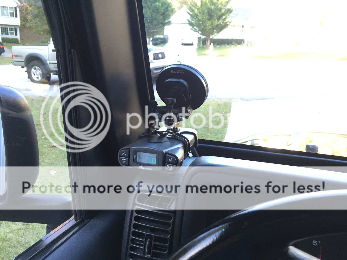

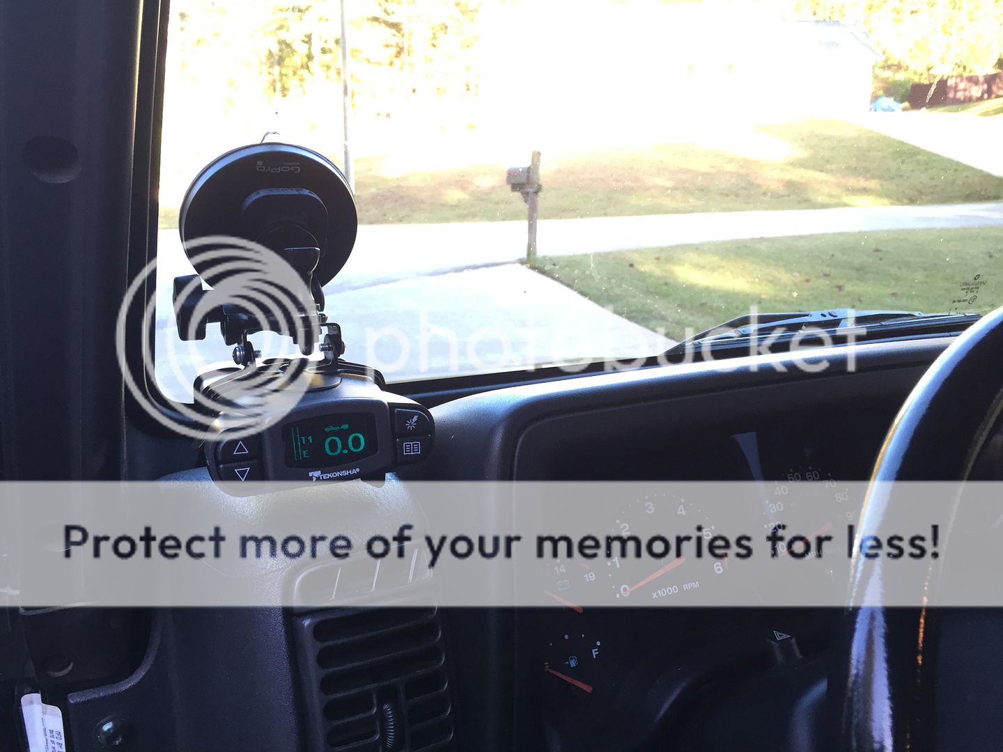

Long term bump/update. I added a tekonsha p3 brake controller to my TJ over the weekend and dialed in the brakes. When I built the trailer I used a 3500lb axle with Dexter spindles/brakes, but have not used them until now. My limited testing so far leaves me very happy with the results. I wanted the controller to be very visible/ accessible when in use but removable when I don't need it, so decided to mount it above the dash via a GoPro suction cup mount. It is ugly, but strong and can be installed or removed completely very quickly.

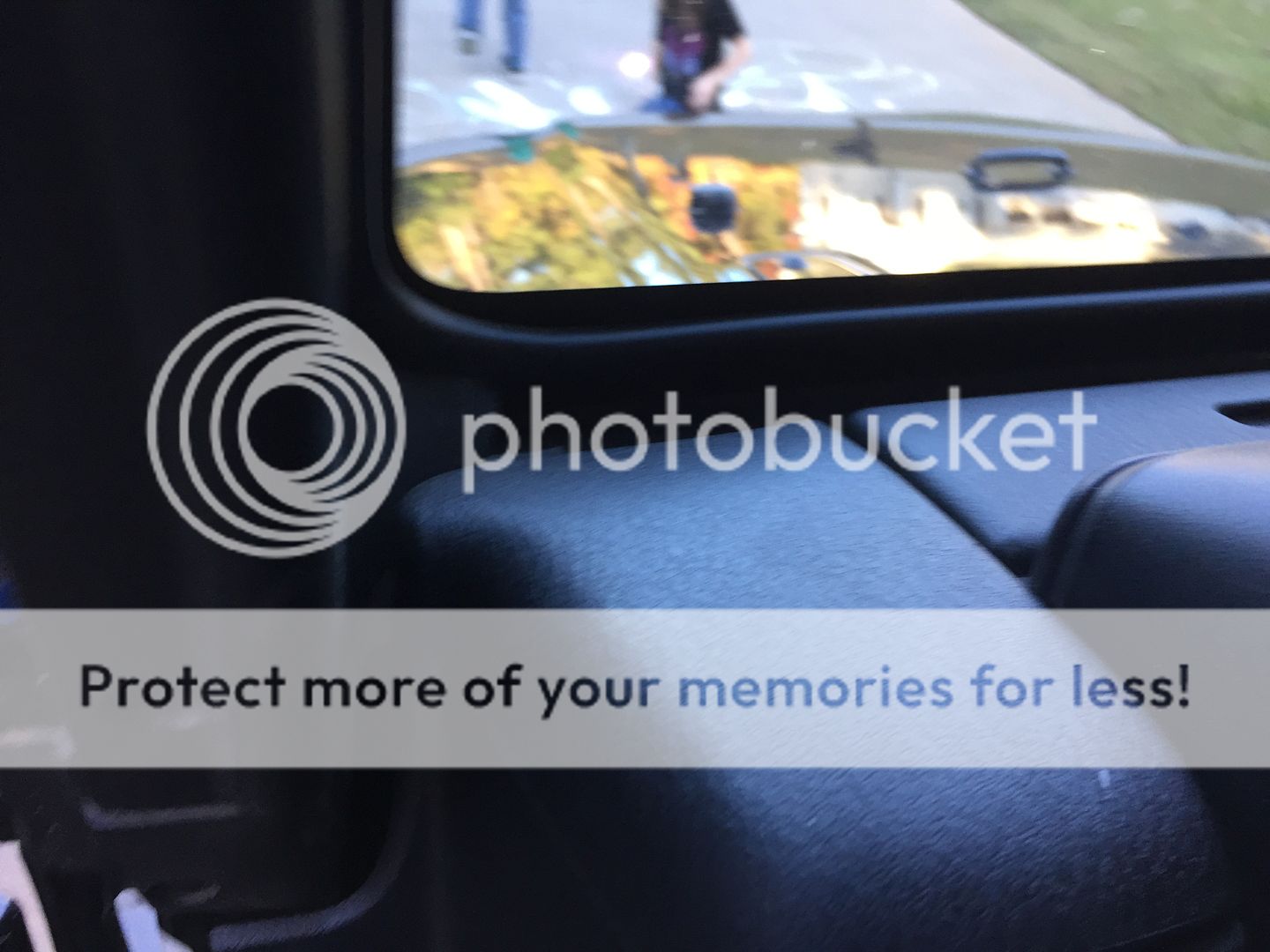

I ran the controller wiring behind the dash and laid it out so that it can be tucked under the dash top trim piece (near the vin plate) when not in use.
