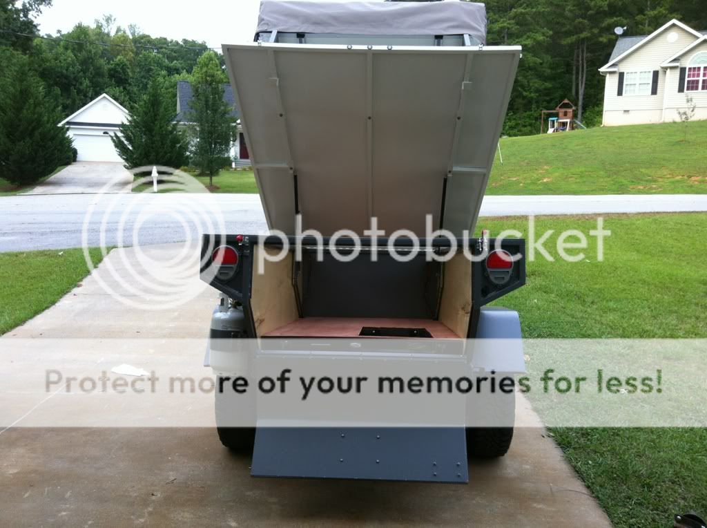

Reassembled after powder coating. The tub is hammered grey, the lid gloss white.

That looks great. Wish I had one.

If I could design a trailer yours is what I would do, great job!

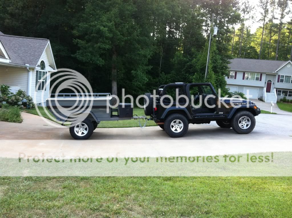

The there are two power systems. The tow system (lights and brakes) is powered by the jeep. The house system ( everything else) is powered by a pair of 12V deep cycle batteries. The two systems are for the most part isolated, but the onboard charger can take 12V from the jeep to charge the batts at a much slower rate than if it were connected to shore power.
The water system consists of a 25 gallon tank w/ 12V pump. It will also include a propane fired water heater (hopefully before it gets cold).

Correct, no waste water tanks (black or grey)

I see the Rubi wheels with center caps. What did you do for hubs? I have not been able to find trailer hubs that fit inside the small diameter of the wheel.

2" spacers

I got the trailer weighed yesterday and it was 1575 pounds with batteries, tent, fridge and empty water and fuel containers.
