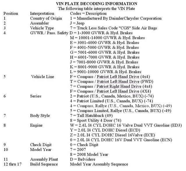

i'm looking into buying a patriot and starting my research. is there a correlation between the VIN# and certain features (like sport, limited, FDI, FDII, etc)?

Yes there is. Are you looking for a printed chart? I have the Caliber one but it's sensibly the same as the Patriot, other than make model.
Try this online VIN decoder if you dont need a printed chart.

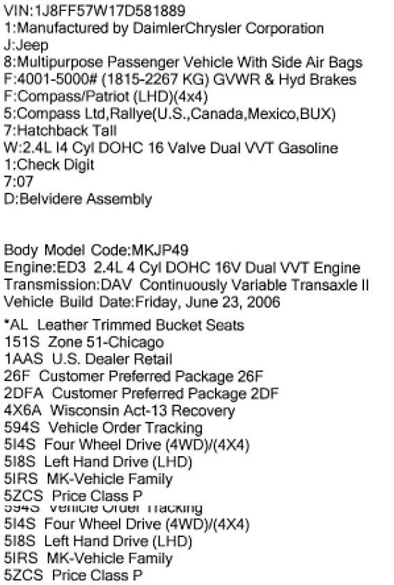

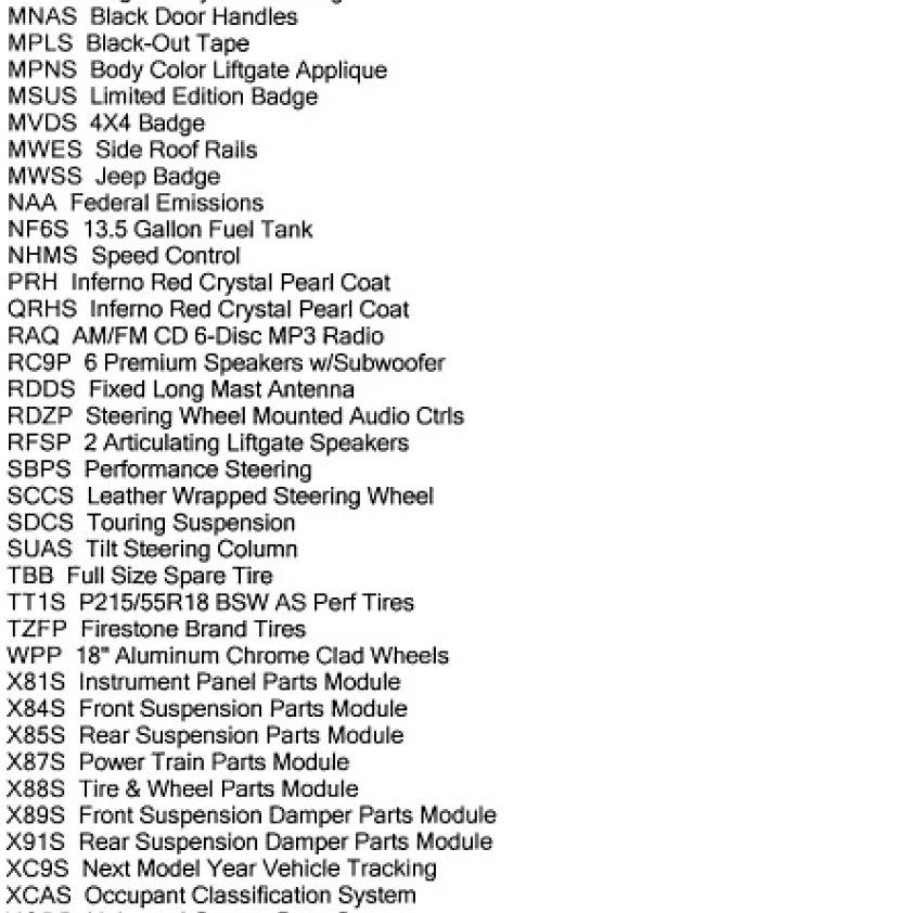

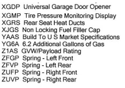

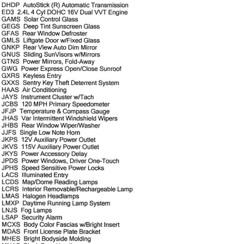

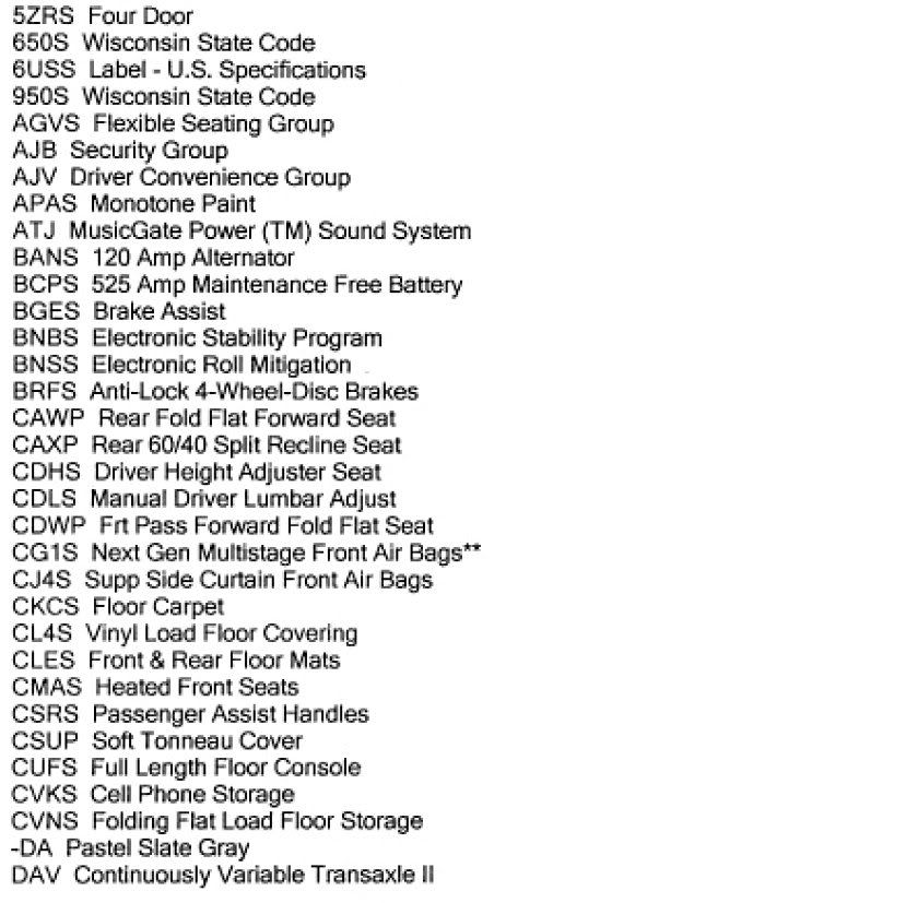

If you take your VIN Code into your dealer you can get a full print out of every module/assembly that was used. It will also include the production date and some other goodies.

This is what your print out will look like.
