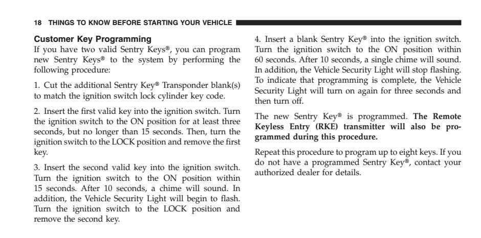

I just traded my '02 PT Loser in on an '09 Compass Limited. The dealer only had 1 key, the one with the remote entry on the key head. They talked to a mobile locksmith for me who could do a basic ignition key for $100 or the one with remote entry for $200. I picked the cheaper option. So I now have 2 ignition keys and one keyless entry 'clicker.' I would like to get a third key so that if I lose one I have 2 SKIM keys and can program my own blank. I would also like to have a second keyless entry fob for the missus.
I have plowed through the forums looking for information on programming an ignition key and a keyless entry fob. I found lots of answers; most of them conflicting and some just plain wrong. There are 2 points I am trying to clear up; programming a new key to work with the SKIM module and programming a pendant to work with the keyless entry system.
On my PT I can enable a third SKIM key by doing some mad juju with the 2 factory keys. I found a reference here saying the '09 Compass is the same but all the references to 'factory' keys makes me worry. Can I do it with one factory key and the one from Mobile Murray?

I should have mentioned that I sealed the deal yesterday and pick up the Compass next week. That said, I didn't even have an owners manual until I downloaded it 10 minutes ago. I have been able to answer my 1st question about programming SKIM keys by READING THE F#@KING MANUAL. The wording Chrysler uses is "valid key" so It looks like I'll be fine. I'm posting this for anyone else searching the forums for the same answer.
