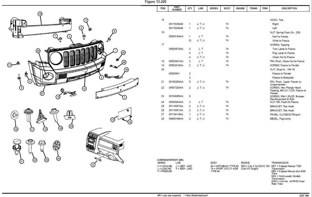

These are pics of the front fascia and bumper structure of the Compass and Patriot. The factory tow hooks mounts directly in front of the frame rails to the bottom of the bumper on the Patriot where they put a convenient hole in the fascia to get to it. On the Compass the closest access threw the fascia is just inboard and would still make a good place for tow hooks. If you were just looking to get by with out doing a permanent mount, you would need a hook on the end of your strap/cable with an 1 ¼ “ opening to connect to the back side of the bumper. (some pictures moved, see post 9 for Fascia removal Instructions).

To gain full access to the Bumper/Frame Rails, you’re going to need to pull all of the Front fascia off. Here’s what to look for:
Picture 1. Remove the fascia (2) to splash shield screws (1).
Picture 2. Remove the lower fasteners (4) and disconnect the electrical connectors (2 and 3).
Compass
Picture 3
1. Remove the fasteners (1 and 2).
2. Remove the push pin fasteners (3).
3. Loosen the fasteners (5 and 6) and remove the fascia (4).
Patriot
Picture 4
1. Remove the push pin fasteners (6) from the wheel wells.
2. Remove the screws (5) from the wheel wells.
3. Remove the screws (3).
4. Remove the push pin fasteners (1 and 2) and remove the fascia (4).

The Tow Hooks used on the Patriot are part number is 5067532AA and list at $17.45. We could not find a pic in the parts manuals and they may resemble the ones for the Cherokee that madrabbit posted above in #7.

I plan on buying the tow hook that fits in the receiver mount for the rear. The fronts are shown below for the Patriot and I'll be installing those too as time, etc permit. I can extract the dimensions from the cutouts that have been posted on another site for the Patriot and come up with where I'll need to cut the Compass bumper. From what I can tell these do NOT attach to the bumper itself but to the frame horns (for lack of a better term).
