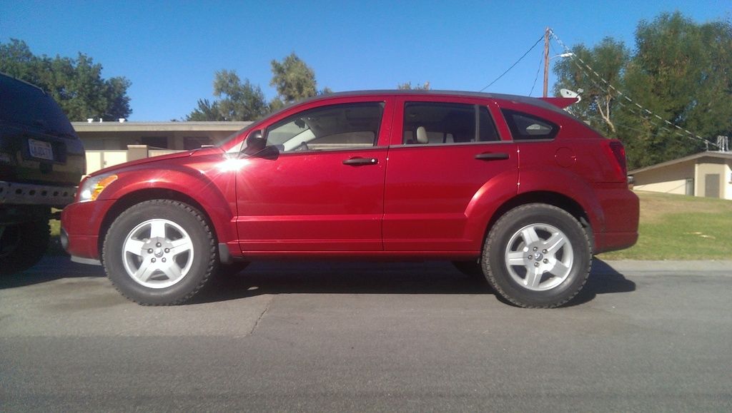

Did you notice if your passenger side axle rubs the mount where the control arm bolts to if you let the suspension fully drop? Looks good btw.
This is my 08 caliber with the same kit.

Always wanted to see a Caliber lifted, is that an AWD one? and what size tires? Not sure what springs came with Calibers but with FDII springs from a patriot or compass you could get another inch of lift.
I'm FDII and lifted, to answer your question yes, I do have binding on the passenger side axle and control arm, however I have this problem because I have my front swaybars disconnected.

No, it's 2wd. I take it into the desert occasionally and it's nice to have the extra ground clearance. The tires are 235/65r17. They will rub on the plastic inner fender at full lock but have yet to rub during "articulation" over rocks and stuff. My swaybar is still connected but if I just jack up the front of the car the passenger side axle makes contact in the same place as your picture. I've read your posts on the jeep patriot forums and didn't see if you had ever found the reason for it. I guess you didn't. I'm going to look into my engine mounts and see if there is a problem there.
