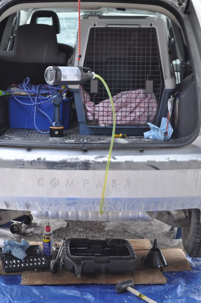

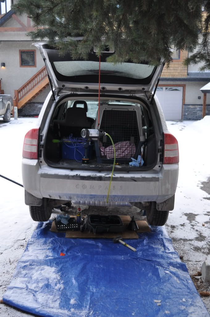

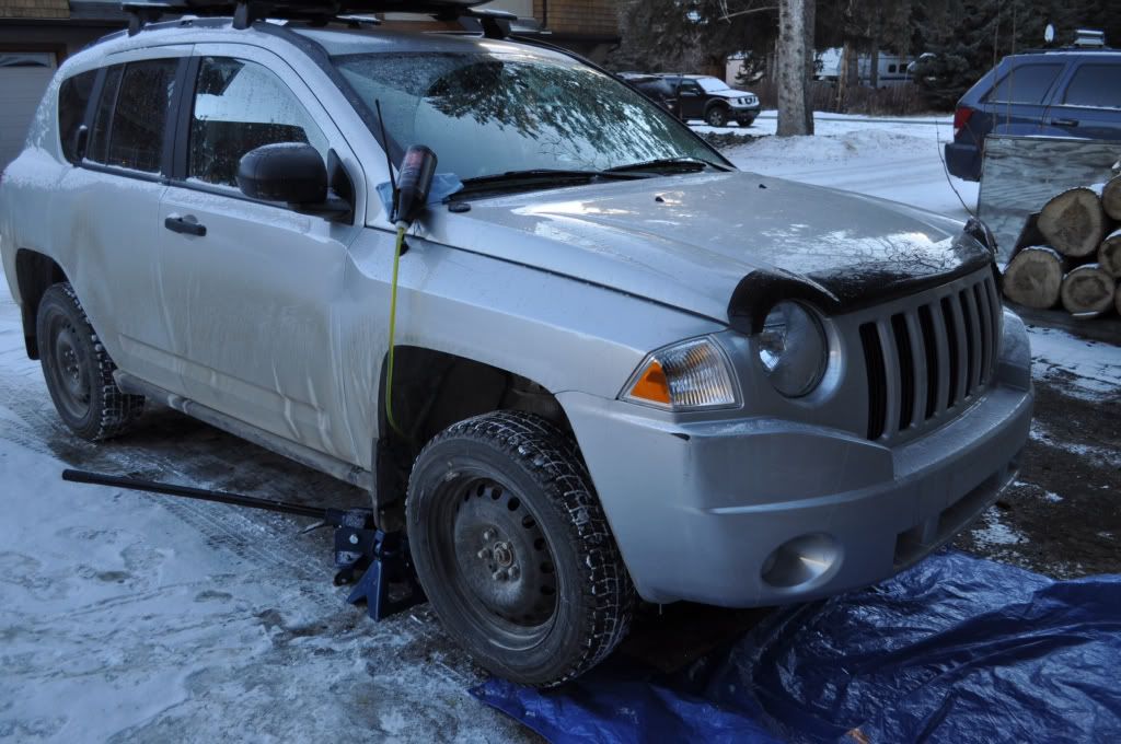

Thanks for the info here guys.... Did mine today, and with the right tools is a simple job (of course I didn't have the right tools to start!).
I would have to say that 0c is probably a little cold for filling gear oil quickly, but seeing as that is as warm as it is going to get here until spring, it had to be done!
The Compass did look like he was on a drip:
Thanks again!

That's a clever way of holding the gear oil bottle when you don't have a pump.
