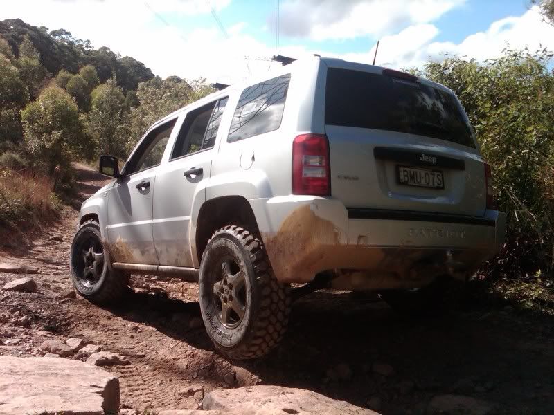

On that maximum tire size... As reported at the "other place", one chap in Australia has managed to run 265/75/16 tires under his Patriot. That's a calculated overall diameter of 31.6" When asked how he managed that, the answer was "spacers, angle grinder, sledge hammer and a blowtorch pretty much sums it up!"
Looks pretty impressive, doesn't it?
