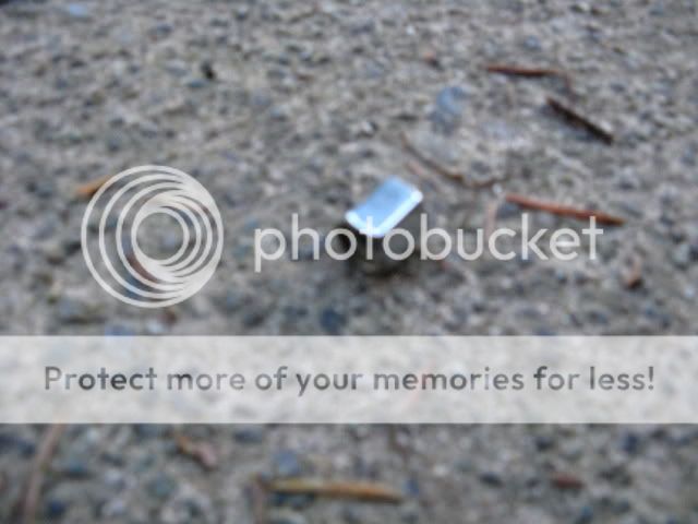

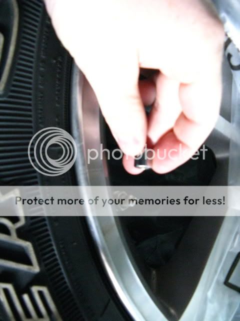

The only lousy part is that my TPMS didn't get transferred to the new wheels (YET). Either Jeep or my dealer (so far un-named) installed metal valve caps that have corroded. The tire installer broke one of them off, and we decided not to break the other two that were also corroded.
I'll be going to the dealer and asking them to remove the other two valve caps and hopefully replace the broken sensor. My fourth sensor already has a plastic cap from a tire repair last summer.
If you have these valve caps, take them off! Replace them with properly speced TPMS valve caps, that have a seal and are plastic.
Others have installed the factory TPMS into the Soft 8 rims, so I'll be having them installed as soon as the broken one is replaced by the dealer (hopefully tomorrow).
