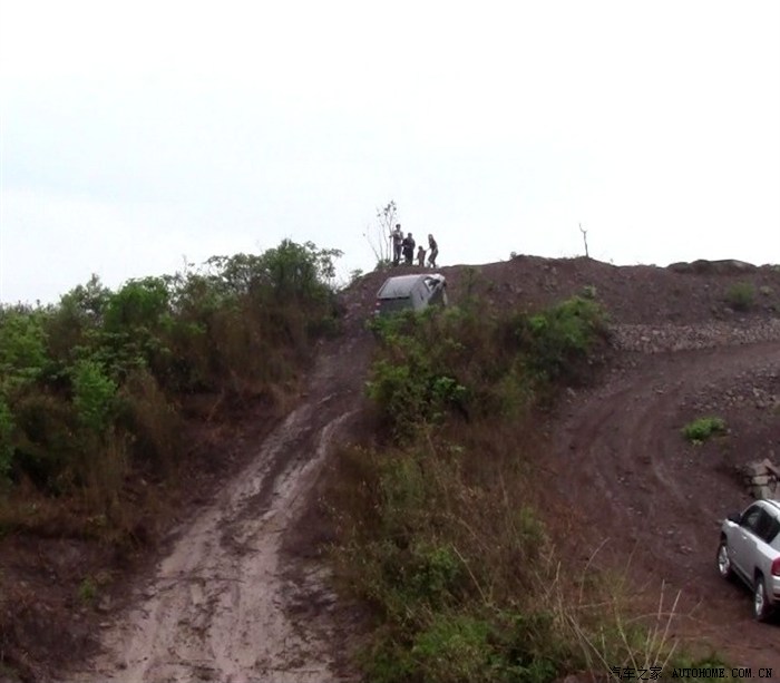

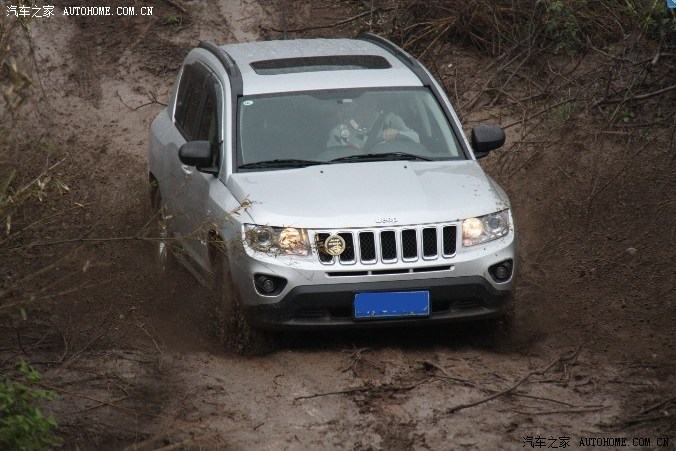

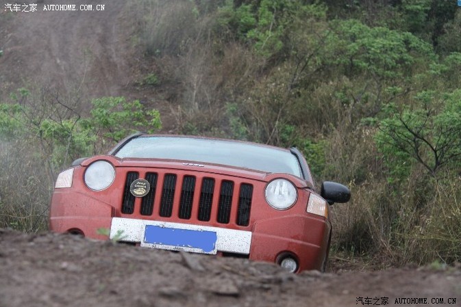

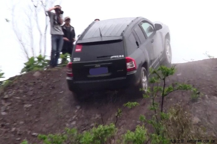

My compass changed the tires with 235/60r18 and the power is loss 7% so I was failure.
The orginal compass 2011 without change tires successfully went to the top.
http://v.youku.com/v_show/id_XMzg5MTU4NDM2.html
http://v.youku.com/v_show/id_XMzg5MTYxMjI4.html
http://v.youku.com/v_show/id_XMzg5MTg4Mjg0.html

wow do you think the bigger tires caused you to fail due to the power loss or due to the over-sensitivity off the traction control braking system causing the spinning tires (probably all 4) to stop spinning (which would help it regain traction but caused you to stop in your case)?

The bigger tires lost power is true. But just like you said, the TCS maybe was the big trouble, when I jamed the engine RPM never go over 2000.
I have found this problem about 4 times already. Maybe next time I should take the ABS pump fuse out and test it.
