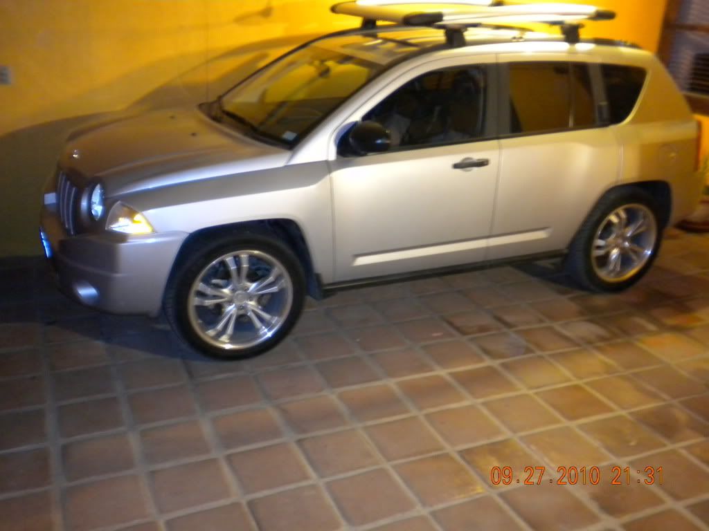

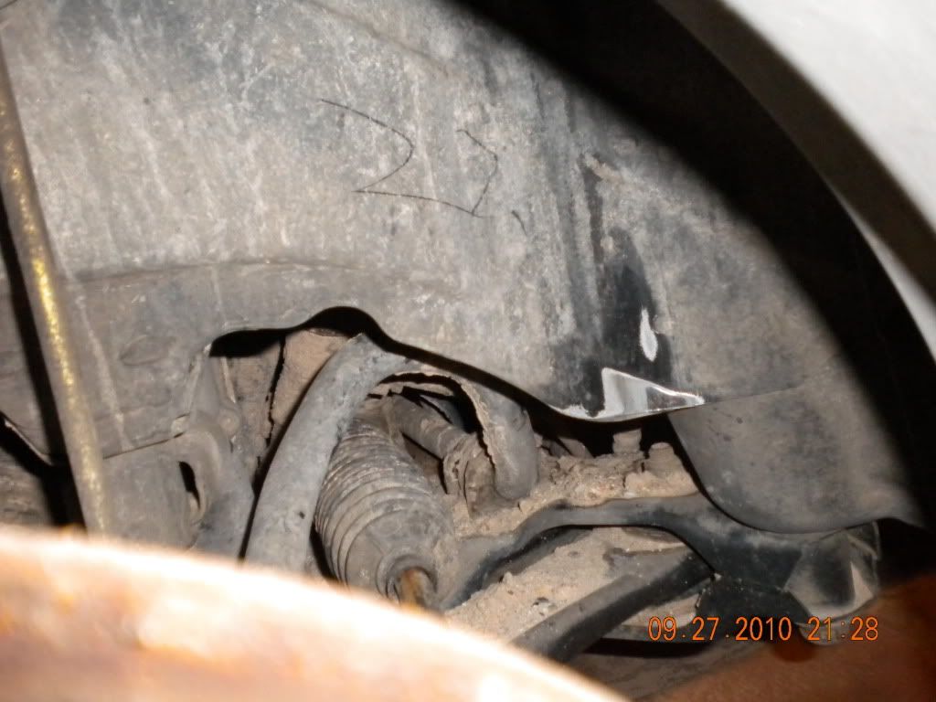

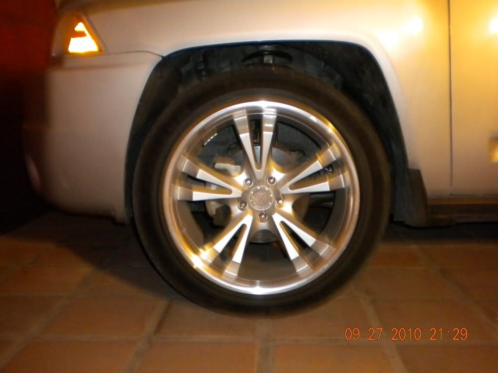

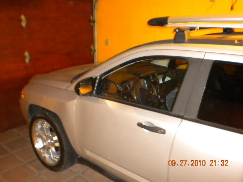

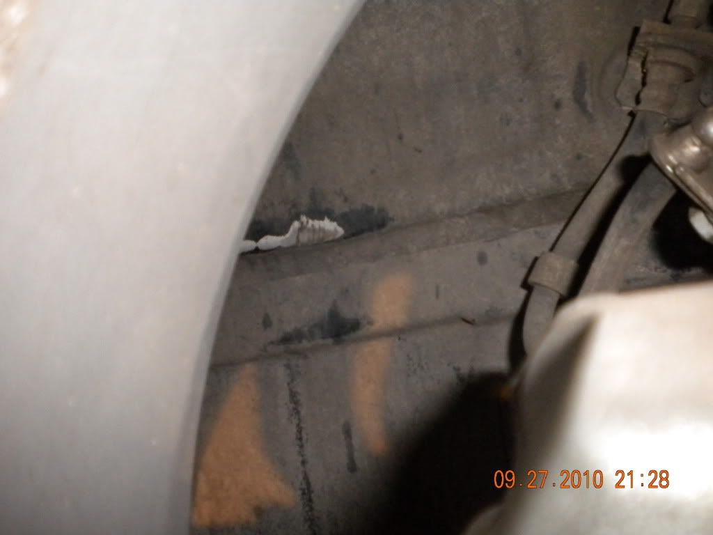

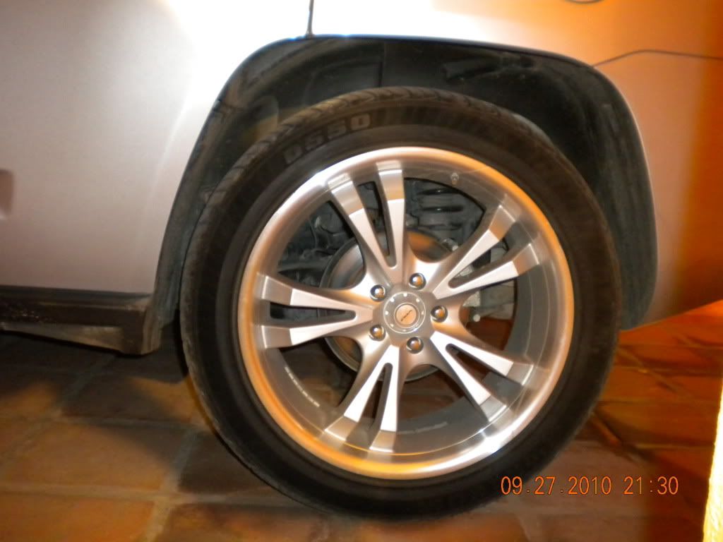

Finally I was able to properly place pics, as you can see the rub is in the inside of th ewheel, I already have some spacers in both front wheels, not sure the size, I do not recall the size of the spacer when installed and I do not have a rule with me right now, but is like the widht of 2 USA quarters together.
My concern in adding more spacers is that if the bolts will have enough thread to properly secure the tire, what would you recommend?
Also I have moticed that when hitting a bumper with load in the back, sometimes I have a rub in top of the rear wheel as well.

el721213 - I cleared up the other 2 posts. I've got to think on this one and maybe some of the others will have some suggestions. It does sound like your spacers are pretty thin. I was thinking more along the lines a 2" spacer +/-" . I'm not saying these are the ones to get, but these are VERY good ones, but they will look like this so that your bolt legth won't matter.

That's what I thought. Those will only give the wheels the clearance to clear the brakes, not the clearance for the tires to stop the rubbing. I've never had to use spacers so I need to do some more research.
