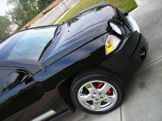

Sorry it took so long to get these up. I've been lazy. Not all of the pictures I took during the install came out very well. I'm not very good with a camera. So, these are the good ones that came out ok. Not sure why they don't show up instead of links. It worked ok when I used the test section of the forum. Maybe Gramps can format it correctly.
Stock / OEM
Stock Airbox Removed
Fully Installed Pictures
...and just because...
2007 Jeep Compass Limited - Black w/Chrome 18" OEM Wheels

Good pictures. I think you left out one clamp -across the metal cradle. I reminded pilzny of the same thing when I saw his pictures. Look at installation instruction sheet pictures #30 and 31. Probably not vitally important, but hey...

Sure do like the Hemi Orange engine cover (looks that color in the first pic). I think I want some louvers on the driver side of the hood too.

Thanks After I did the brake calipers I had some leftover and thought the engine cover would be the ideal way to set off the engine bay. Definetly looks like hemi orange to me. I didn't expect it to look that way when I bought the paint, but thats how it came out.
Going to go back and reread the instructions noted above as well. Thanks for letting me know about it.
