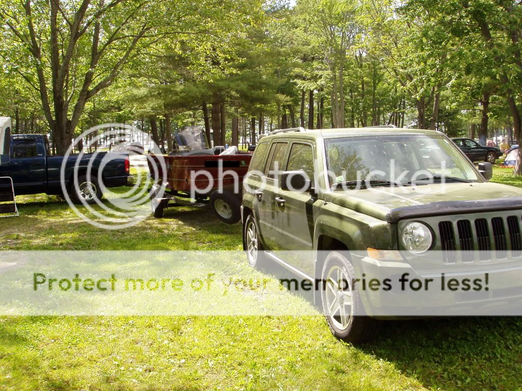

I finally got to take my boat on a trip with the MK. It pulls it just fine. In fact it pulls it like the boat is not even there......except going up hill in 5th gear on the highway, but that is to be expected. There was no trailer sway at all. Other than an issue with the wiring harness I was very impressed.
Here is a couple of pics of the boat hooked up to my very dirty MK at the campsite. Sorry no pics of it launching or pulling from the lake due to the wiring harness issues. I'll try to get some of those on our next trip.
