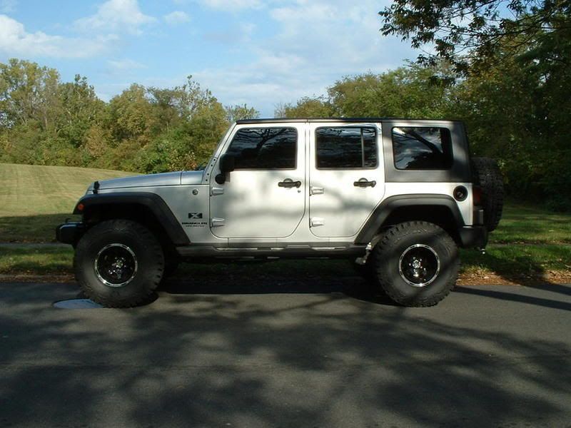

Ok the lift from Zone products is complete and I could not be happier. It took me and a buddy approx 5 hours to complete with out any iproblems. It looks absolutely great and no "ESP" issues at all. The ride is 10x smoother than factory and the wider stance makes it alot more stable. Below are some pics of the completed project.
One issue with the 15 inch pro comp 8179. My rear pass caliper was about 1/4 wider than the rest. So the wheel weights were just barley scraping causing a slight squeek. I just took it up on the highway and it worked itself out. If you get these have them put the weights closer the the front then the back of the rim if at all possible or use only 7 gram weight not 14 gram if it can be helped.
Also, with these 35" tires, I did cut out about a 4" triangle from the plastic piece below the bumper. Not a big issue but it was rubbing on full turns.
So far I and completeley satisfied with the 3" susp lift from Zone Offroad. It is the best kit for the price and the look is awesome. If you are hesitating because they are the new kid on the block... don't, you won't have any regrets.
I do have pics as the insall went on. PM if you need any or have any questions.

Here are some Pics of his JK with 3" Zone Lift
