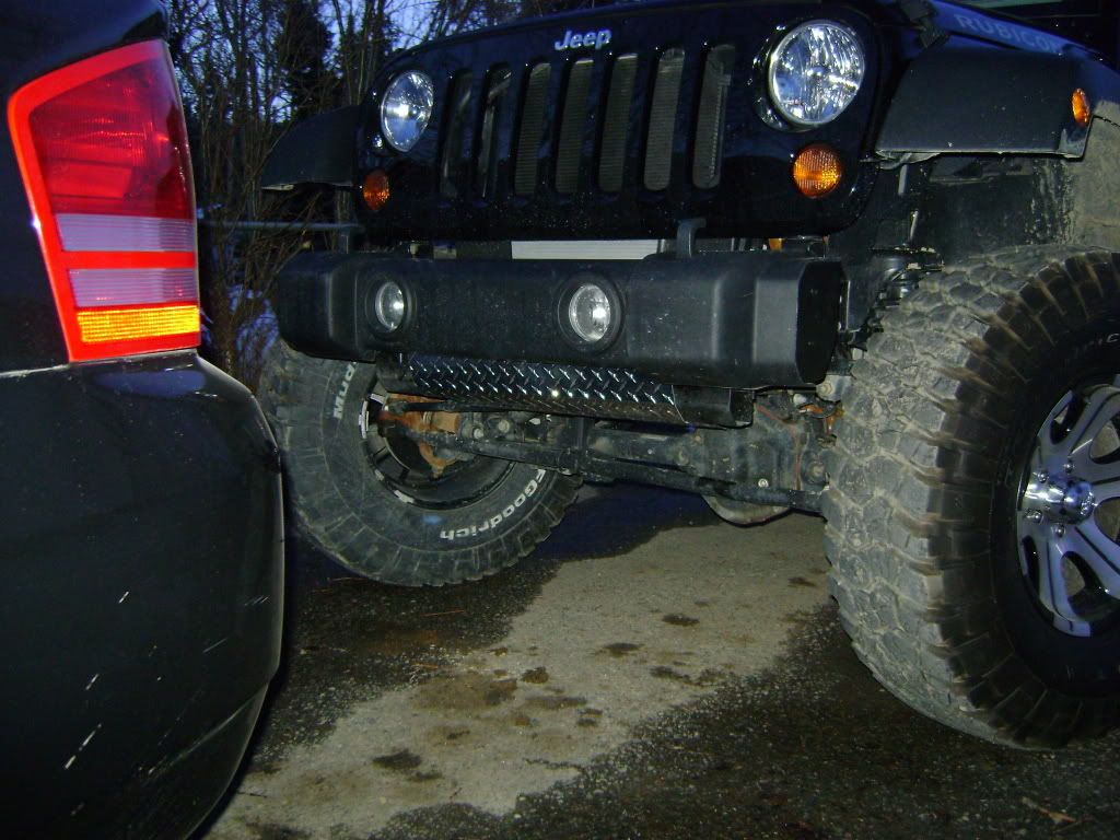

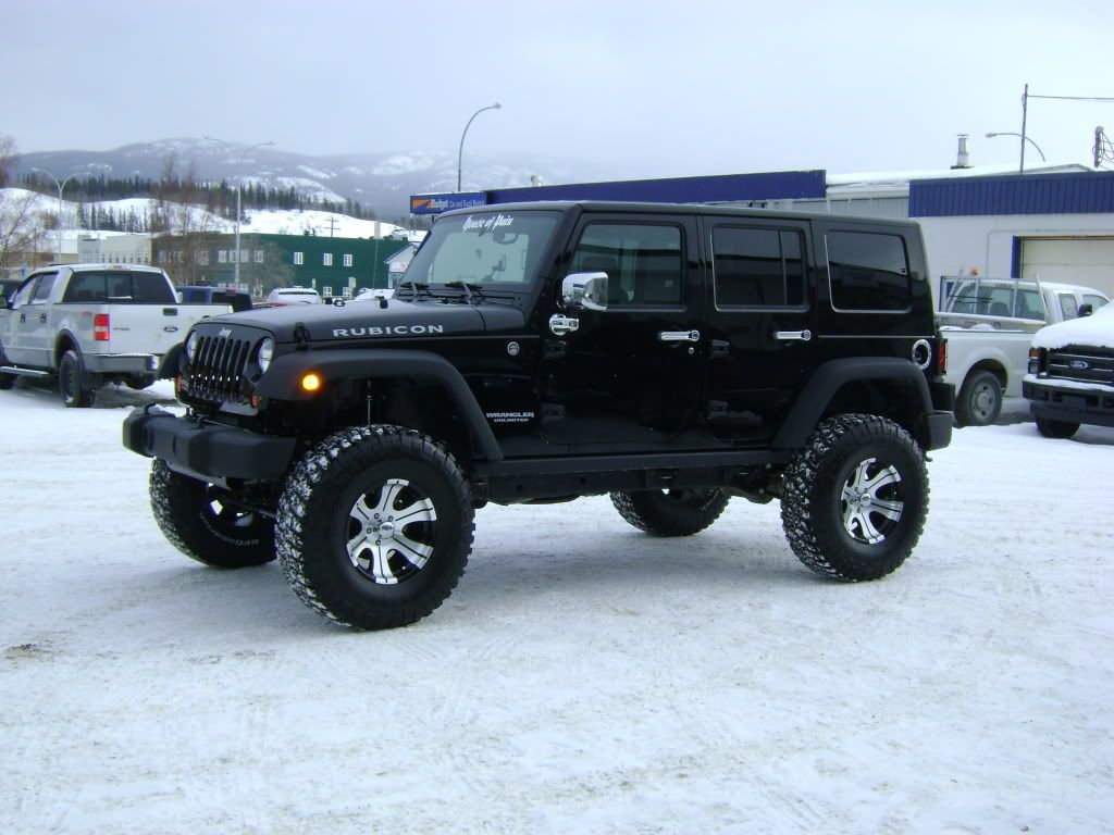

Is the gap in the front too noticable with the 2in BL? I already have the RC 2.5in BB. Does anyone have a picture of the front gap? Idk if i like the visibility of the frame on the side.

here are a couple pics, front and side

I like the look of that, the front isnt too bad. The frame visibilty on the side ive never been a fan of. I can see my whole frame from the side on my 2500 Sierra and I hate it.
