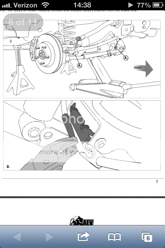

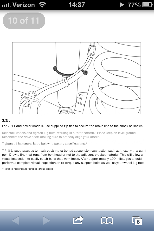

Are you sure about that now? My brand new 2012, right off the lot, had the front brake lines between the spring and the shock. I think that started 2011. The lines went through a bracket on the lower shock mount.
Here is pics from the manual, straight from AEV.
brianjw is offline

How am I fighting you? I'm providing facts, not guessing based on a pieced together lift. Check my revised post above with AEV instructions for HIS suspension system, relevant to HIS jeep.

What does a pieced together lift have anything to do with routing? I posted a picture of a stock setup on my Rubi. All of the ones I have seen have it going around back behind. And like I said, maybe the 12's and up are different I cannot say as I do not wheel with anyone who has the newer jeep.
Edit: looks like the 11's and newer have that routing, in reference to the drawn pictures. I find that scary
And if by pieced together lift your are referencing my jeep, I very much like my setup the way that I did it. I dont need "AEV" to tell me how my suspension set up. I pick what components are best for my set up. A kit does not do that.

My comment was based on your link to your "lessons learned" thread and your picture of the stretched brake line. I was implying that your thread and your setup didn't apply to a complete kit such as the one the OP has installed, with brake line brackets and a specific routing that works. Personally if I started over again I'd build my whole suspension (hell the whole jeep!) from individual components. My suspension started as AEV and is becoming more and more of a frankenlift with AEV, synergy, metalcloak and other components. I have nothing against pieced together lifts. It just didn't apply IMO to this guy's lift and directing him to do something contrary to the factory setup and contrary to the instructions supplied with his suspension system.
There is nothing scary about the way AEV has it routed. Before they told people to zip tie the brake line to the shock (to prevent chafing) I split a larger rubber hose and wrapped it around the brake line near the shock, and zip tied it anyway. With it tied to the shock it isn't going to bind up in anything. As shown, they come routed in the same place from the factory and as far as I know, nobody has had an issue with it. Not even before they told people to zip tie the brake line up.
