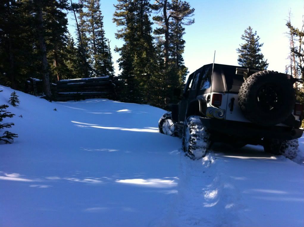

Jim, just for your situational awareness, here I am clawing through snow. It wouldn't go anywhere without chains in this kind of snow. There are situations where chains are essential.

I get the principle, but you aren't doing this. I've been in snow and there is no staying on top of it. This video demonstrates the principle but we aren't doing that in our JK's. I live in Denver and grew up in PA, I know snow. In fact, airing down really just pushes your diff, and body closer to the snow. That will stop you sooner because ultimately, we aren't stuck until there is too much snow for us to push or, if like in my video above, it's a solid chuck of ice.
We're getting 15 to 20 inches here in a few hours. Maybe I can shoot some demonstration video if 20 inches stops my Jeep. I don't think it will though.
