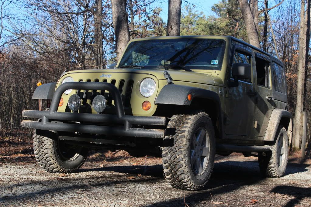

You could easily keep your 16" rims and buy a 32" tire like a DuraTrac 265/75R16 and you won't need any modifications nor will you have to worry about the warranty.
If you buy 17" rims you can go as big as 32" tires without any modification/spacers/leveling kit. Here is my 2013 JKU with 17" stock rims and Mud-Terrain T/A KM 255/75R17. It's the same tire that comes stock on a Rubi. You could find a nice deal on Craigslist with some ones take off rims and tires.

You could easily keep your 16" rims and buy a 32" tire like a DuraTrac 265/75R16 and you won't need any modifications nor will you have to worry about the warranty. If you buy 17" rims you can go as big as 32" tires without any modification/spacers/leveling kit. Here is my 2013 JKU with 17" stock rims and Mud-Terrain T/A KM 255/75R17. It's the same tire that comes stock on a Rubi. You could find a nice deal on Craigslist with some ones take off rims and tires.
Did you put a lift on yours? Your set up is almost to what I'm looking for. Not enormous tires, but big enough to give ya an edge when off roading.

I have no lift on it yet but I'm going to put a 3/4" leveling kit on the front only sometime soon because it's a bit nose heavy. Then eventually I'm going to put on 33 inch tires and different rims with a 4.50" back spacing.
