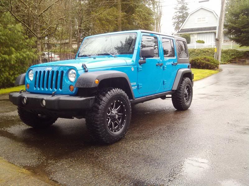

for reference, heres a pic of my 2011 JKU with 33's, on 17x9 wheels (w/ 5" BS) with front poly spacers (about 1.5", iirc) only (to level it out)

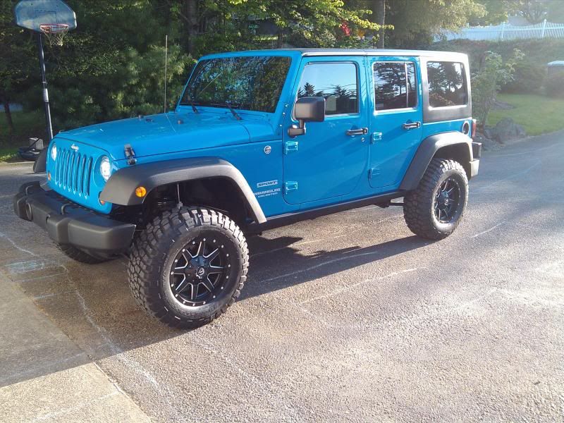

and here it is with the same leveling kit, AND 2" BDS coil springs
