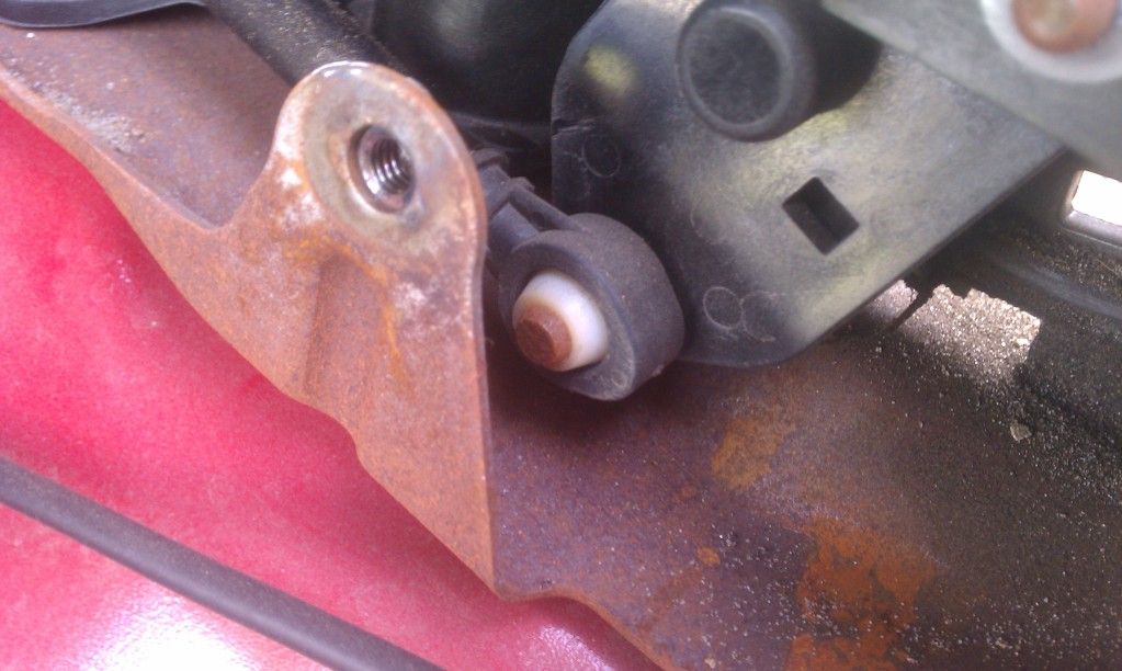

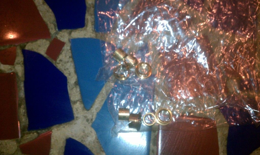

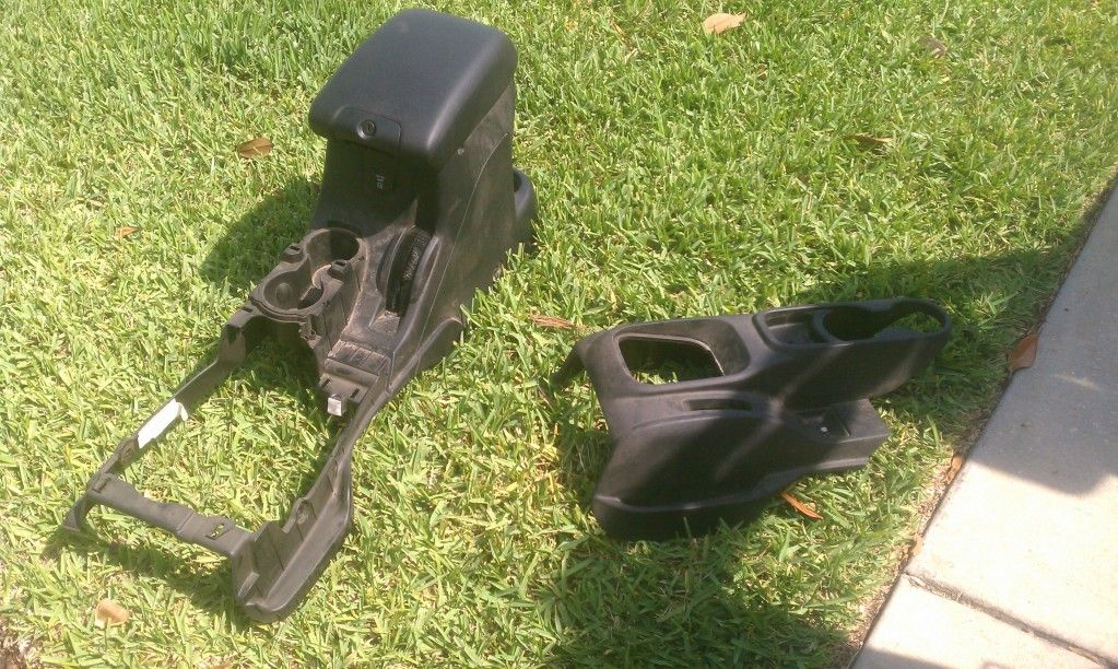

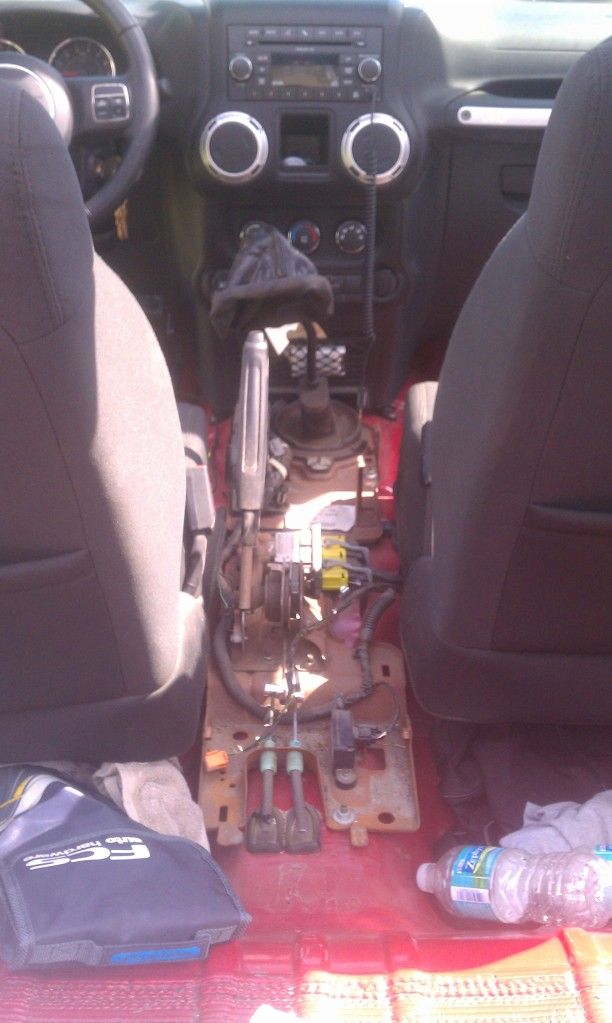

Replaced the plastic bushing on the 4wd lever with something a bit more durable
all taken apart
after getting the shift knob off and disconnecting the power inverter and cig lighter thing, plastic came right out
super cheap plastic
the shifting process is so much better now. Reminded me of the difference when I put brass shifter bushings in my old car.

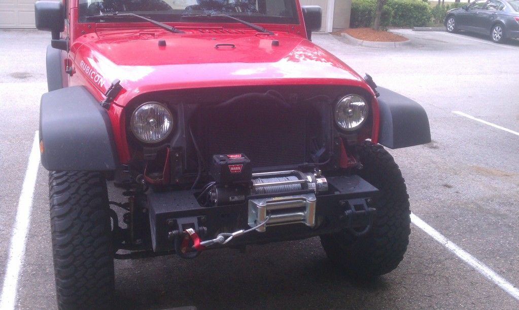

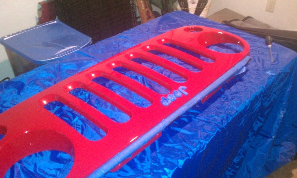

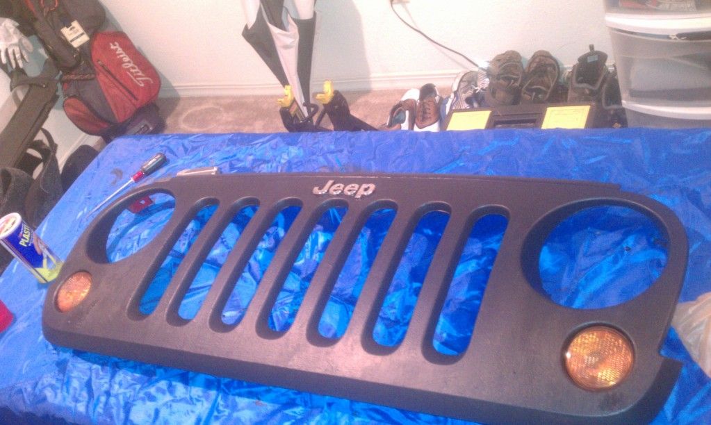

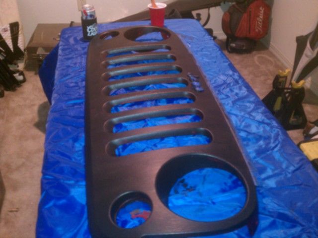

So I got curious and decided to plasti dip my grill tonight. Pretty cool stuff. Seems durable, I'll be driving two hrs down to ocala tomorrow morning, wheelin at hardrock, and driving back. Should be interesting to see how it holds up.
No grill...
Ready for hardrock tomorrow!

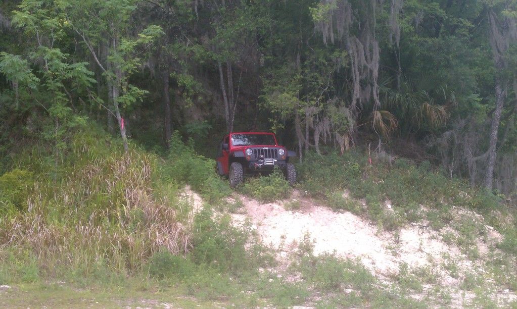

rubi did really well out at the rock quarry.
Still need to install my front skid, order my snorkel and work on getting the inside bedlined, but she's almost done!

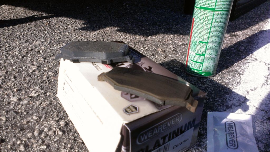

Busted my winch rope, need to replace that. Looking for a new steel cable, figure I'll probably smoke that one in the future so its less expensive than synthetic. Had an awful screeching coming from the right rear wheel. Well after just over 20k miles the pads were shot. Gotta say I'm pretty surprised about that

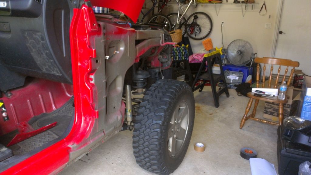

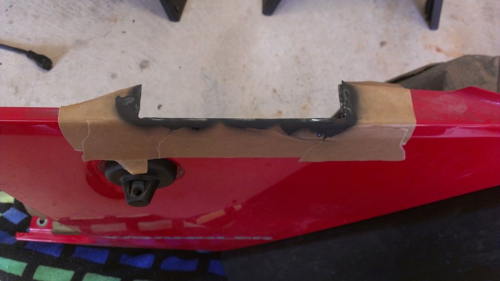

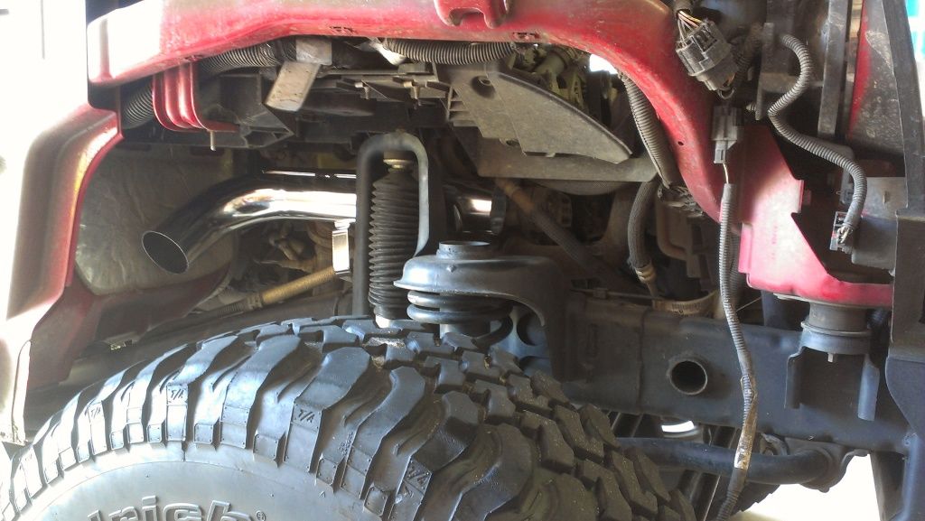

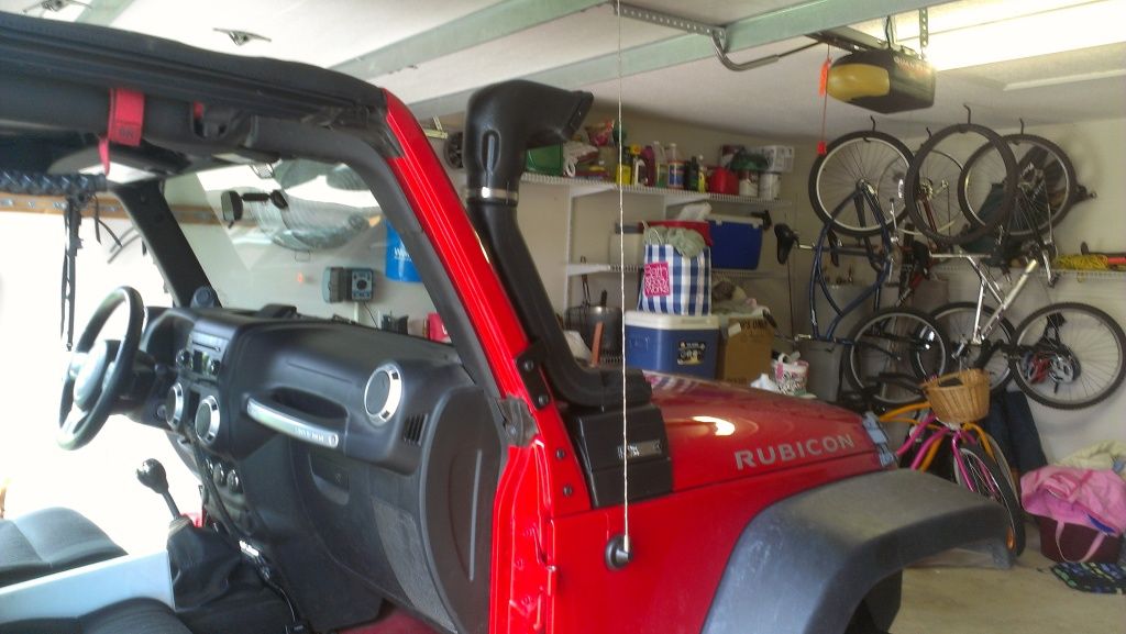

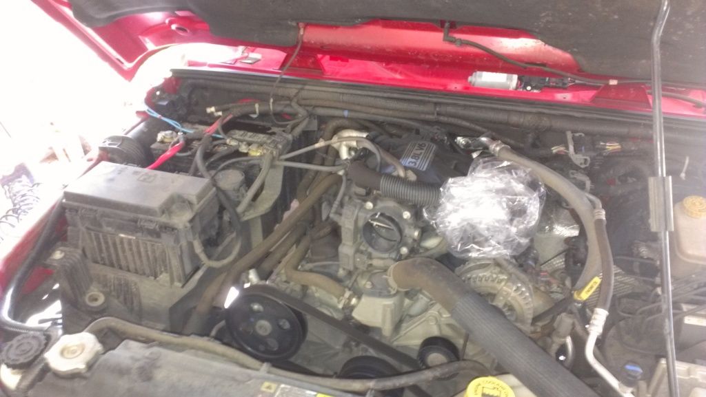

Keeping the thread alive, tons of pics. So I installed the snorkel and a bunch of other items. Here's some pics of the snorkel install
Took the old box out.

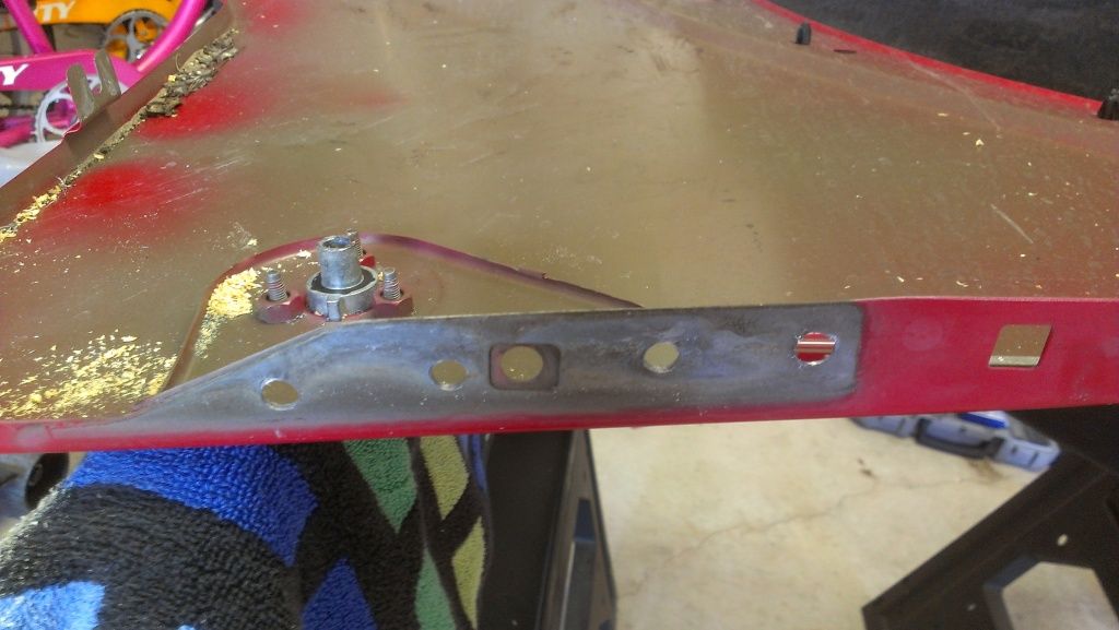

Had to take the fender off to get it all installed.
This tap would need to be cut off, other than drilling out a few welds, its the old altercation to the vehicle needed.
Here you can see where the system is routing your airflow.
Cut and painted, almost done.
Installed...
So I have had this thing on for a while now. I've since turned the opening of the intake towards the windshield. The filter sits right above the opening into the bottom of the airbox and there's a black circle where it does all the filtering. Really trying to find a way to make sure I keep the dirt intake at a minimum. Additionally, this thing does make some kinda cool noises, to be expected when you add a more restrictive (in my opinion) intake. I'm very happy with how it looks and works, I have some video of wheeling since the install and its allowed me to feel much more comfortable. I do need to see if I can get a waterproof seal around the airbox by using hylomar blue.

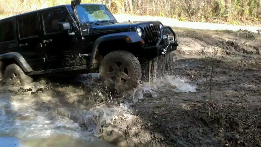

These pics and videos from here mark the start and persistence of death wobble...
Got stuck in a whole that was rutted out by a rig with 44's
Thats my front end after getting pulled out
https://www.youtube.com/watch?v=kcS1...e_gdata_player
Thats the short clip of me getting stuck, next is the 4dr supercharged rubi on 37s that pulled me out
https://www.youtube.com/watch?v=8_R2...e_gdata_player
Now here's a good shot of the water line on the side of my rig.
This guy pulled me out....

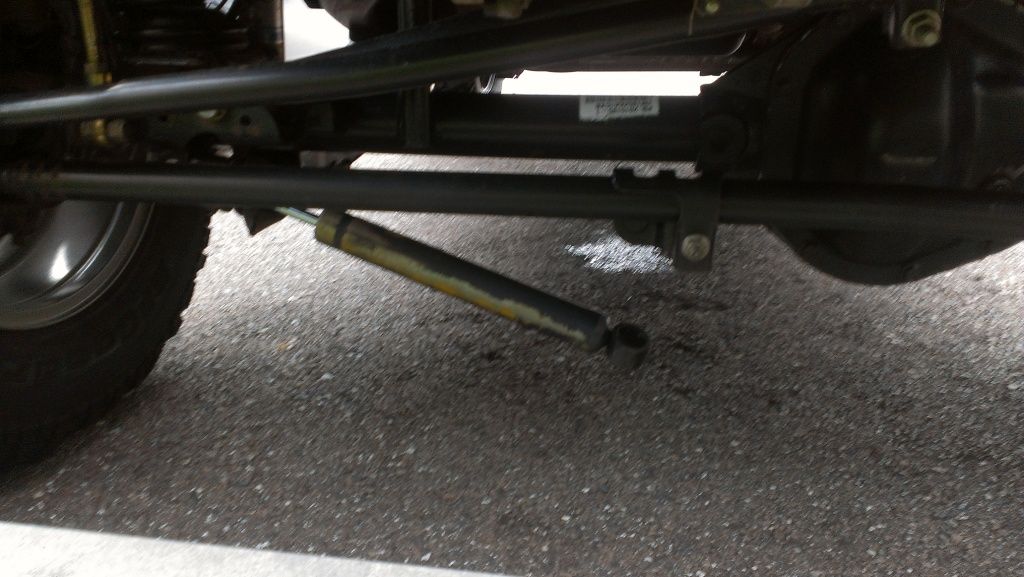

So not too long after I got stuck and eventually ripped out of there, this happened...
Ok, no big deal I think. You don't really need a steering stabilizer, but I'll replace with with an aftermarket one. So I buy the procomp steering stabilizer. This thing is a piece of garbage. Do not buy one, it is literally a waste of money. The shock breaks every month due simply to street driving, you can get it replaced, but its such a PIA to have to constantly replace a crappy product. This did however clue me into some issues developing on my rig. My trackbar bolts were not fully torqued down. I checked them shortly after the lift install but not that often after. Well I developed death wobble and its a nightmare. Most people (jeep people included) around here don't really know what it is. So its been a challenge to fix this mess. Well I tighten up everything, feel pretty good, get the alignment set and go wheelin again. Here's some pics..
Have some good fun, get all kinds of mud stuck inside my wheel. That throws my wheels and tires out of balance, get a nice shimmy/wobble/vibration on the way home. I ended up removing an obscene amount of mud from the wheels and then not too much later death wobble came back and now I can't drive on the highway.

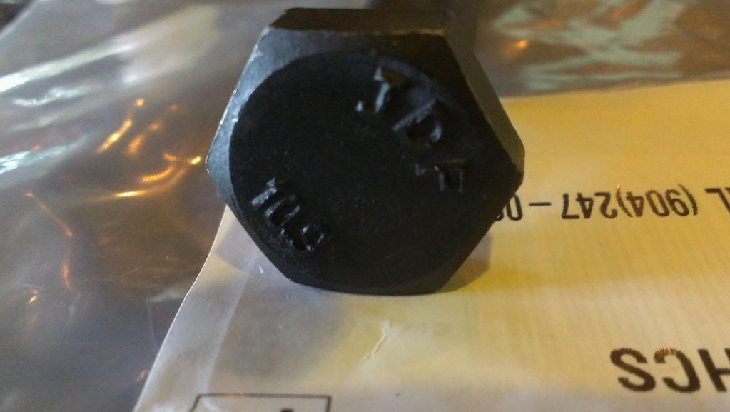

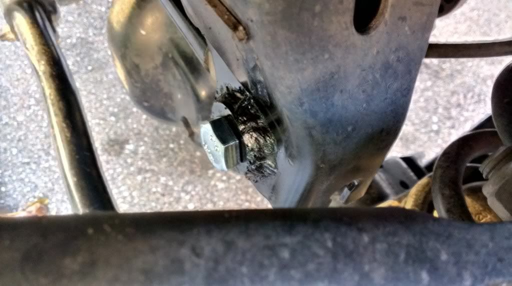

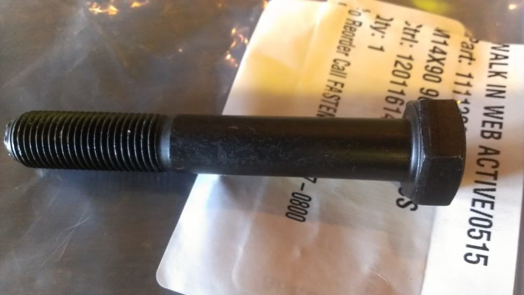

Today I got the class 10.9 bolts I ordered from fastenal to put through my trackbar mounting brackets. Cost $25 for both including shipping. I needed to order new ones because the factory bolts were not long enough to get a nut to thread on bc I welded some washers together and to the brackets to eliminate the play in that poorly designed joint.
here's what the washer sleeve looks like....
Here's the new bolt. Right now I've got a weaker class 8.8 in there which I'm worried about.

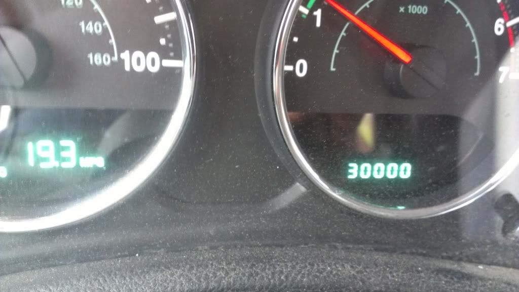

And I hit 30k on the jeep today...
