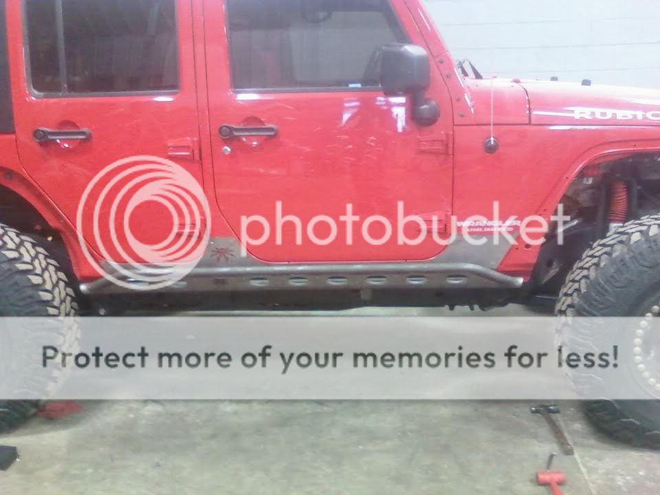

Started installing my PSC stuff today. Still got along way to go.

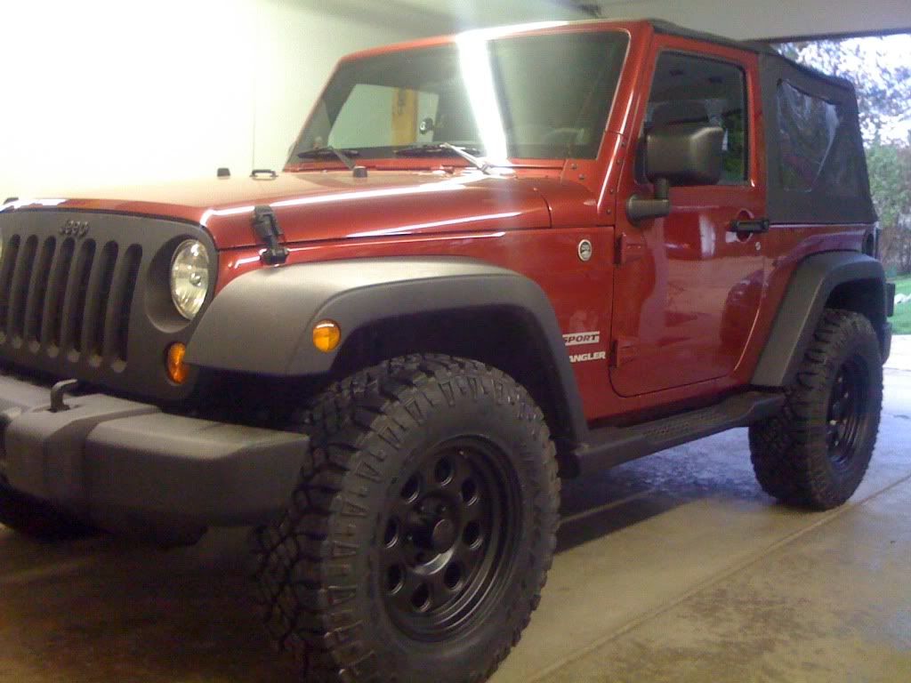

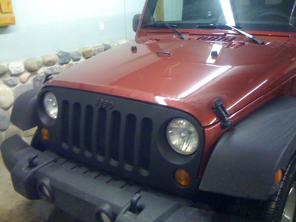

progression of my 2012...
first mod=grill guard and truck bet line the grill
put on some new rubber today! GY duratracs 285/75R17 with black rock wheels
How easy was that grill work? I've thought about it but can't really decide if its worth it. Looks really good on your rig tho. I like it.
it was really easy. i went to car-part.com and bought a new oem grille for $60. that way incase i messed it up or didn't like it i would still have my original one. it takes about 5 minutes to pull it off. the prep work was what took the longest. i sanded down the new grille with 150 or 200 grit sandpaper. the grille was already black plastic so i didn't worry about using any acetone or whatever. i bought the jeep badge off ebay for $7, just because i liked it and bed lined that too. i did 4 coats. bought the bed liner at home depot (2 cans)
