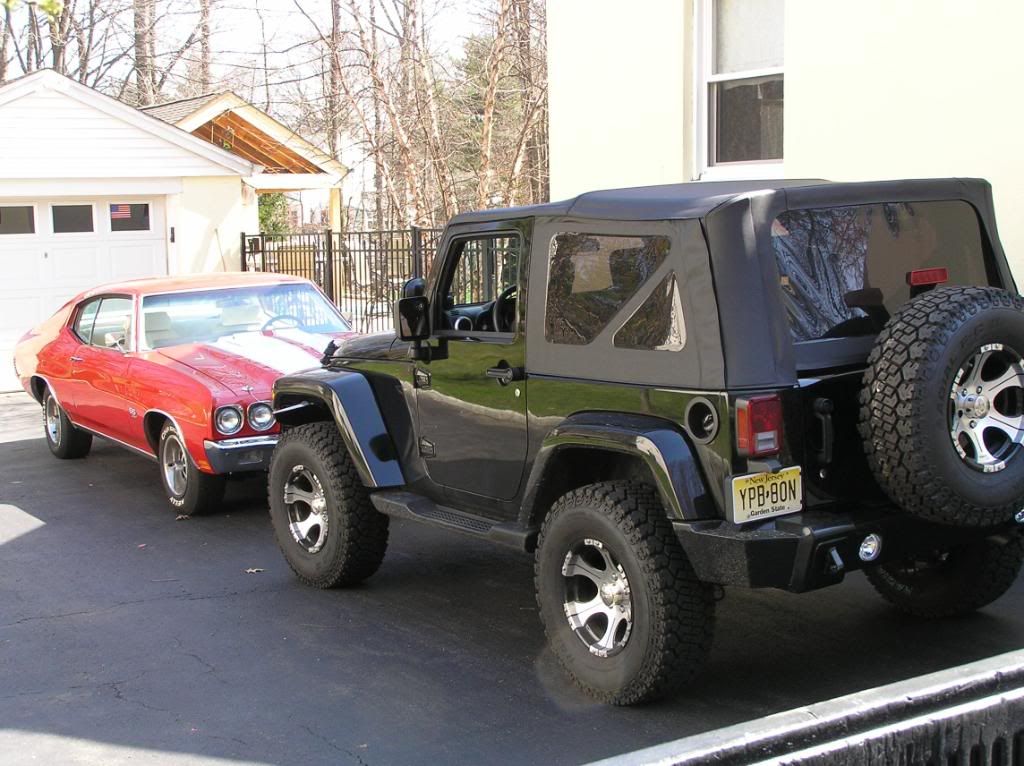

Originally Posted by VetteDriver View Post
That looks very slick. I do like how clean it looks with no decals too.
However, you should include the Chevelle in the background at least once.
Here you go VetteDriver . I had to totally redo the front bumper because like an idiot I reused the stock nuts as I did not get the new ones. I then figured out that they were loosely threaded onto the studs on the bumper and were acting as spacers. Not even spacers either, causing it to not line up properly.. Now the bumper is straight, even and back another inch. I felt like such a tool but **** happens. Then I had to remove the rear and drill out the frame holes to drop the bumper another 1/8" and shim the top out about 3/16" to stop it from rubbing and hitting the tailgate. Finally done and I'm happy it's all done right and straight.

Very cool setup (on the Jeep to keep this in topic).
And awesome Chevelle - that is such a classic style.

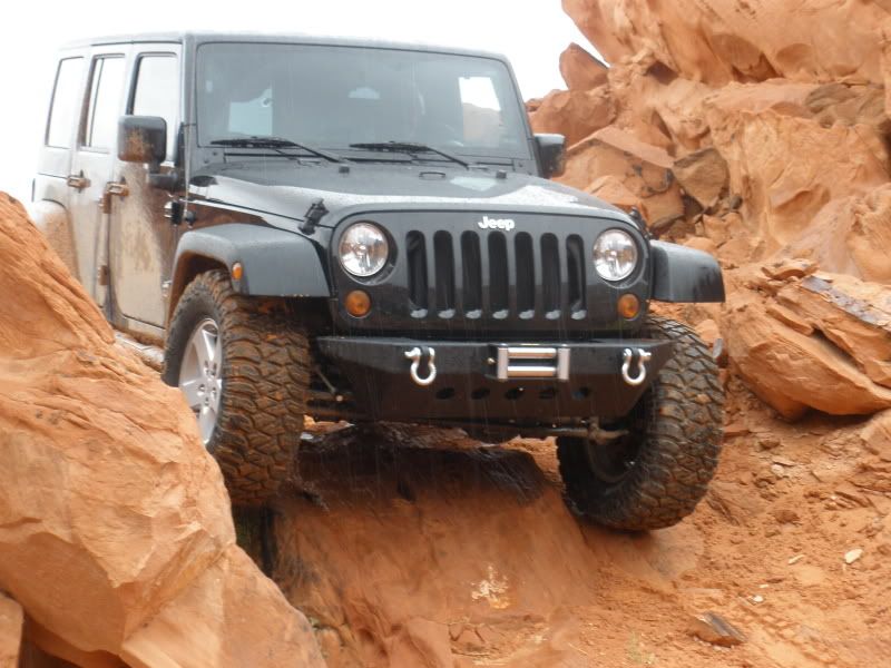

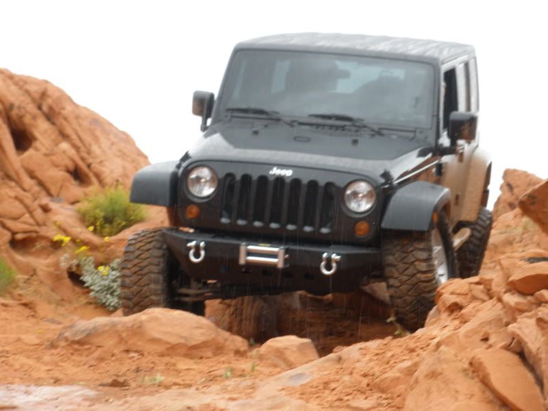

Added BDS discos and got the jeep dirty today.

seriously, great pics man! awesome

roger where was that at backside of valley-of-fire I am also from vegas got a 09 2door jk I offroad with backroaders we have so much fun
Thanks!!
Its in Logandale.You have to pass the Valley of fire exit on 15 north.We went to the county fair and the trails are right across the street.Ya it was fun and the rain made it even better.Lots of rock crawling for sure.
