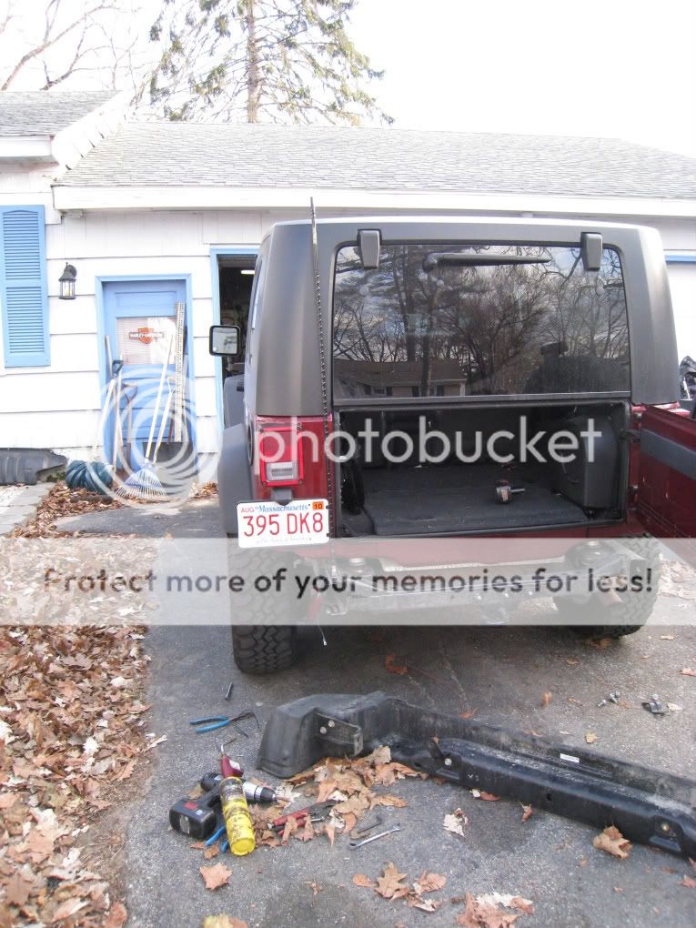

Well, Last week I installed a CB. Still need to put the PA under the hood.

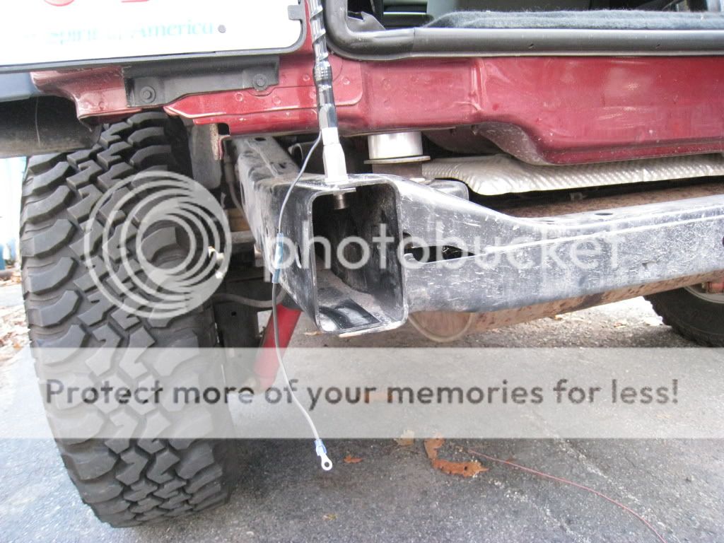

Mounting antenna onto frame, Had to make a small half circle shim do to the overlapping C channels to create the box frame:

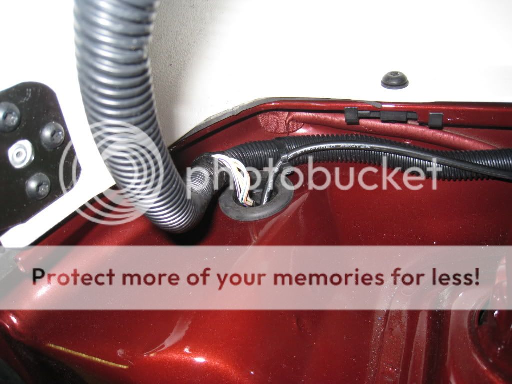

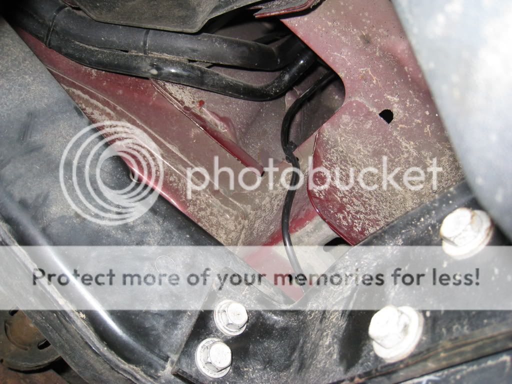

Running coax into the jeep, This is up behind the rear wheel, in the well:

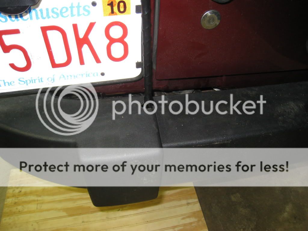

Notched the bumper and made it look all pretty:

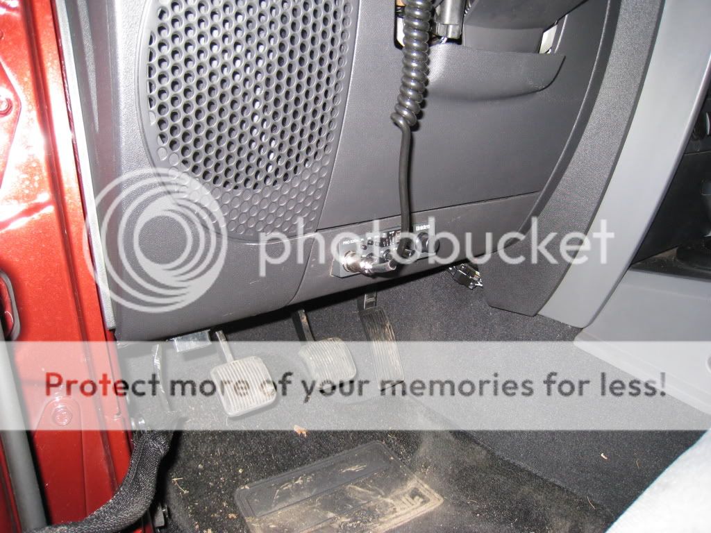

CB mounted. can see it perfect from sitting in the seat. Just the righ location/angle. Sound is loud and clear.

What is your swr reading with that antenna not sticking much more than a few inches past the top ?
