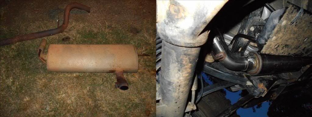

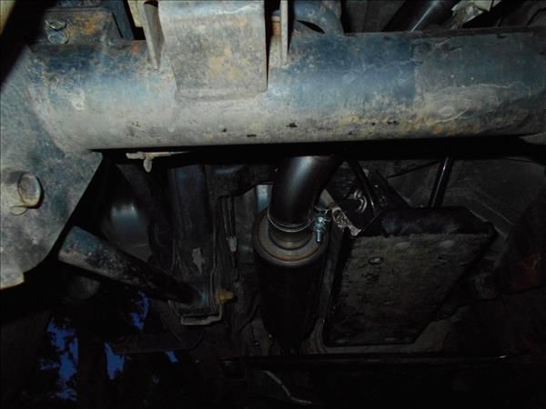

I went to MBRP's S5518409. Its all stainless steel, and tucked up forward of the rear axle, above the bottom of the frame. Not only that, the stock muffler alone weighed in at 22lbs, this is entire system weighs only 17. The aft end of the tailpipe is turned down, no tip. The video could be better, but what the hell eh.
It IS super light and super tucked, but not without headache. You do need to decide if it bothers you that your muffler is now 2 inches away from your evap canister (which is plastic). Now they DO make a heat shield/relocator that both throws a steel plate between the two AND moves your canister over another inch. I have ordered it but haven't installed it yet.
For now I just put up a piece of sheet metal with heat resistant cloth in between the two. (Sharp eyes may have noticed a muffler strap around the edge of my evap canister skid, that is what is holding the sheet metal off the muffler itself) I personally think it will be fine, though the manufacturer considers it necessary. Alternatively, one could chop/bend the now useless heat shield above where the old muffler was, and put that in between.
Dynomax makes a slightly cheaper version, I *think* theirs doesn't quite locate the muffler so close to the evap can. Kinda leaves your tail pipe more at risk though. (If you wanna check it out, Quadra has it. Look for Dynomax high clearance)
