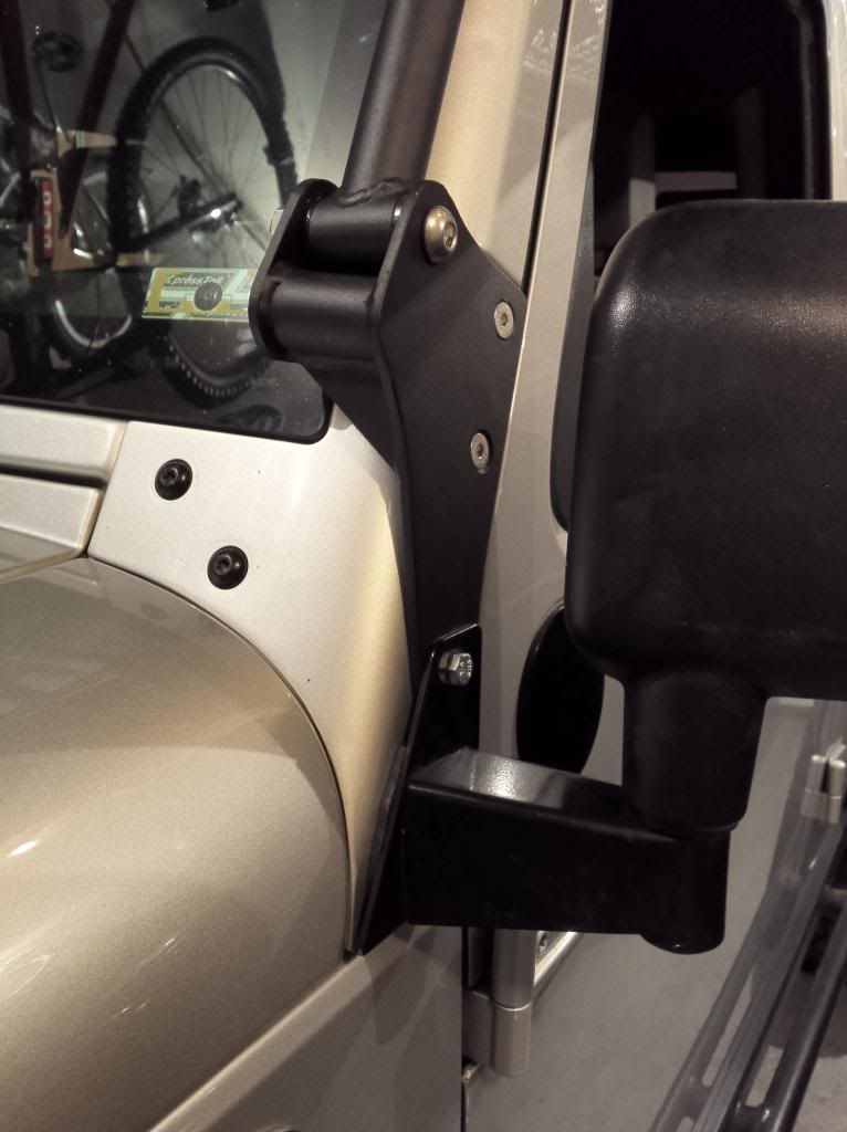

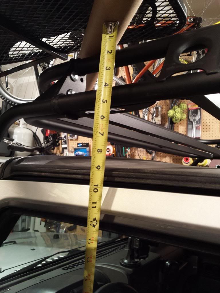

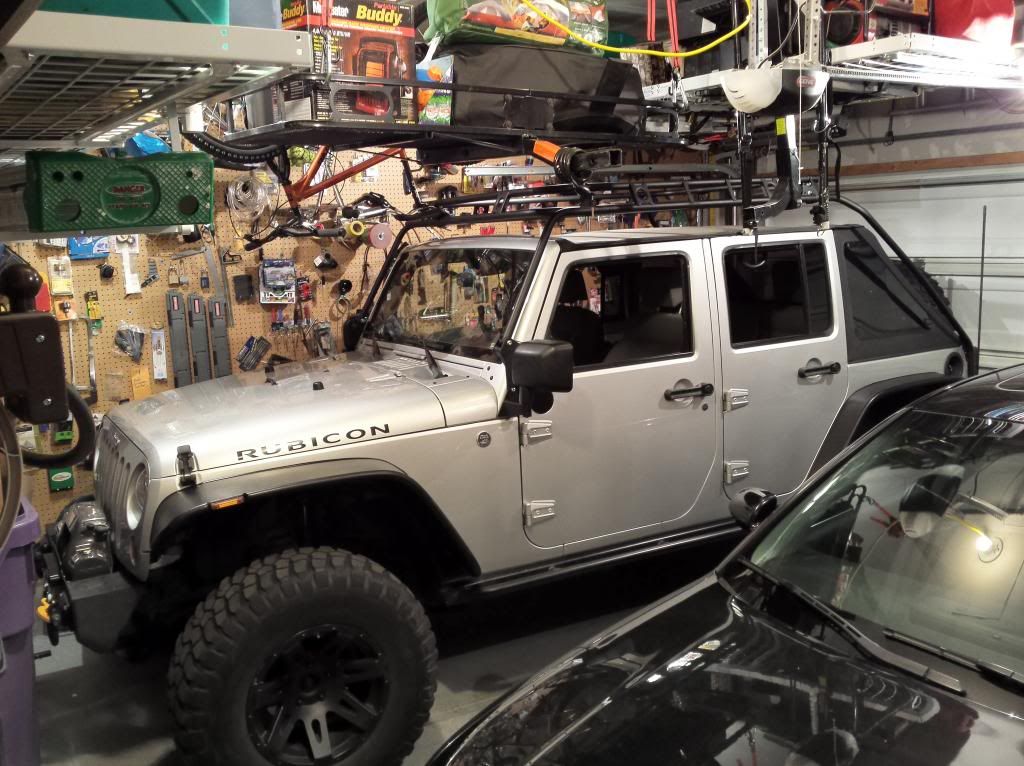

According to Warrior products, this rack adds 10 inches to the height of the Jeep. I installed it today and shot a few photos. Thier 10 inch claim appears to be accurate. I have an Expedition One rear bumper and Bushwacker fenders so their mount for the rear was incompatible. Instead I cut off the cradle part of their mount and mounted it to the bumper. It turned out pretty well. Conveniently, the rear mount that they provide is the same gauge as the front rack mount, so I cut a spacer out of it so that I could keep my mirror relocation brackets. There was no drilling in the body or the roof. I think I'm going to buy this ladder so I can get to it: http://www.amazon.com/dp/B0037OMZL8/...6EN03RDE&psc=1
