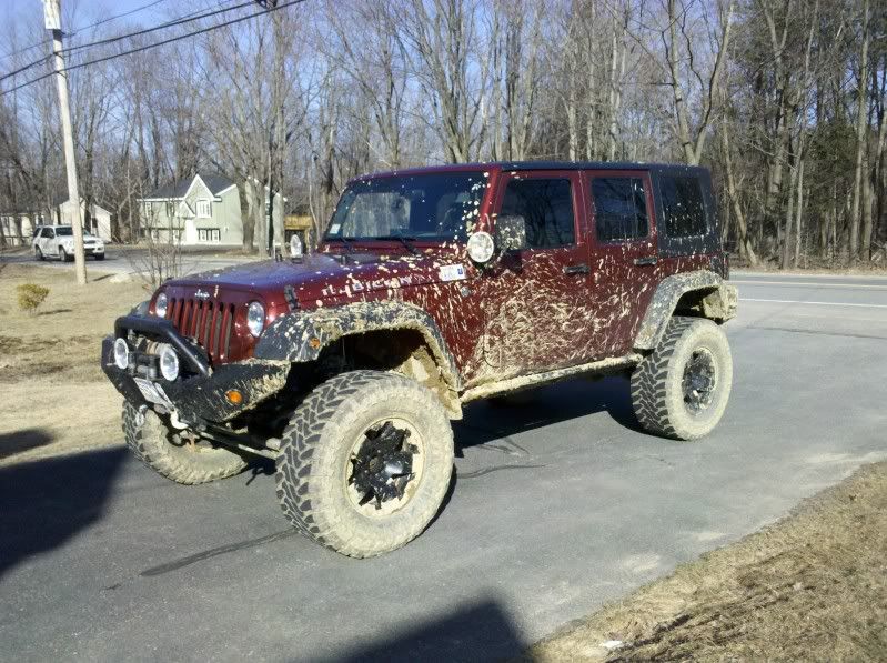

post #21 of 35 Old 10-17-2012, 12:08 PM
HappyTrails
HappyTrails's Avatar
Location: West Georgia
Posts: 2,956
Originally Posted by SubAtomicGenius View Post
Remember JK lift usually follows the rules: 3"=35"s, 4"=37"s, 6"=38"s minimum, probably 40"s.
Not necessarily. I am running 37's with only 2.5" of lift and flat fenders.
This pic is with a RK 2.5" Max Travel and before the flat fenders:
2008 2-dr Rubicon, auto,
RK 2.5" Max Travel, Rancho 9000XL shocks, 37" Nittos, 5.38's, RR skids, Warn VR8000-S.
RIPP Gen 2 Stg 2 Supercharger.
