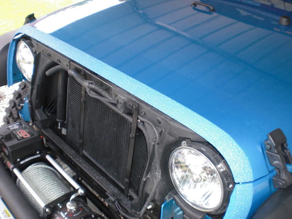

The top mts are the most important, so be sure those are solid, then either use the plastic "T" pins, or eeven zipties,at the bottom, because all pressures are horizontal and against the rad-
I bolted the top and used the pins at the bottom-2yrs, no problemo

Nope, no effect on Rad, because-
Originally Posted by deerassassin22 View Post
^^^^ Does this affect the radiator at all and engine temp with it mounted in this spot?
The aux cooler is mounted on the face of tha A/C CONDENSER, which is in front of the rad.-
