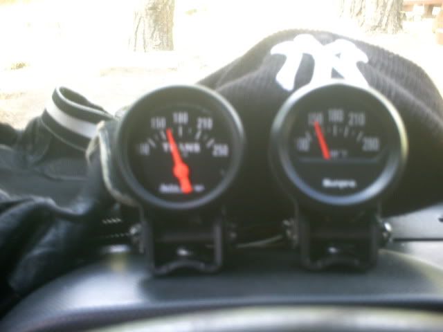

My redundant "dual" aux cooler system, including (2) tranny fluid gages, was a little less than $200 bucks--self install and I don't have the TBS that "reflashs" the '08 jku for "Hot Oil"--
My temp stays at 150 F on level freeway and never gets over 210 towing my 1000lb trailer on/off-road, including hills/rocks/snow-
