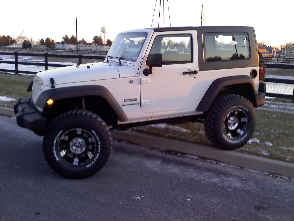

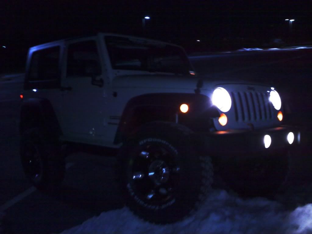

From the side

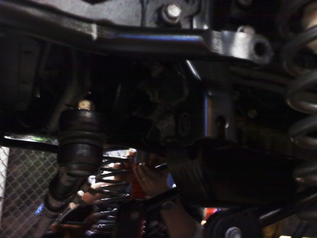

A closer look, only lower control arms are on
Still needs to go on
Also needs to go on

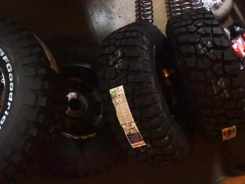

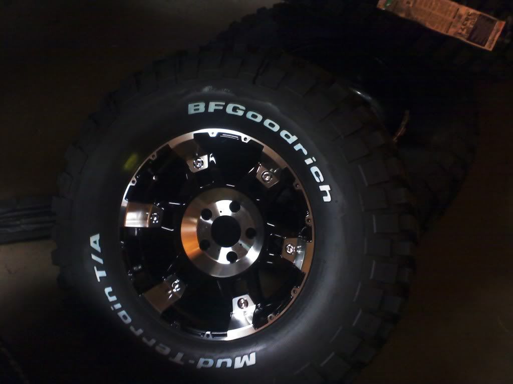

35" BFG KM2's
17" XD spys

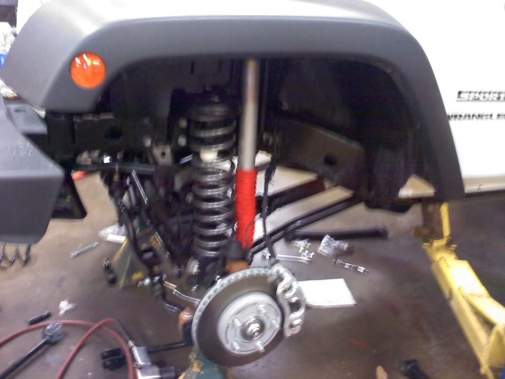

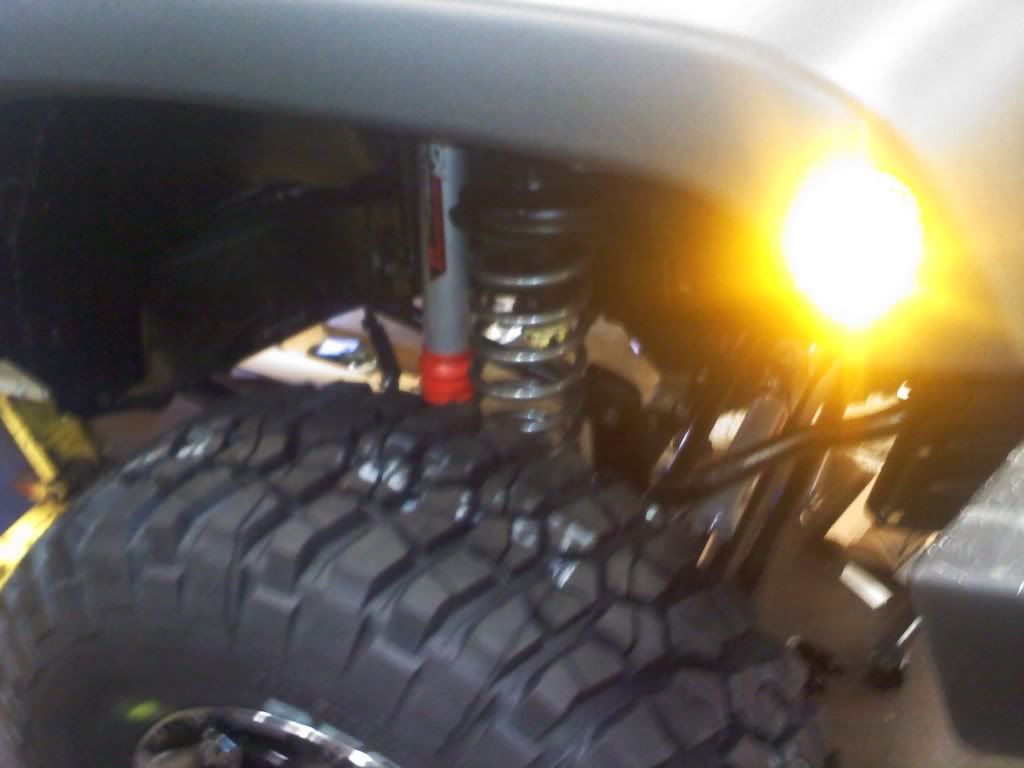

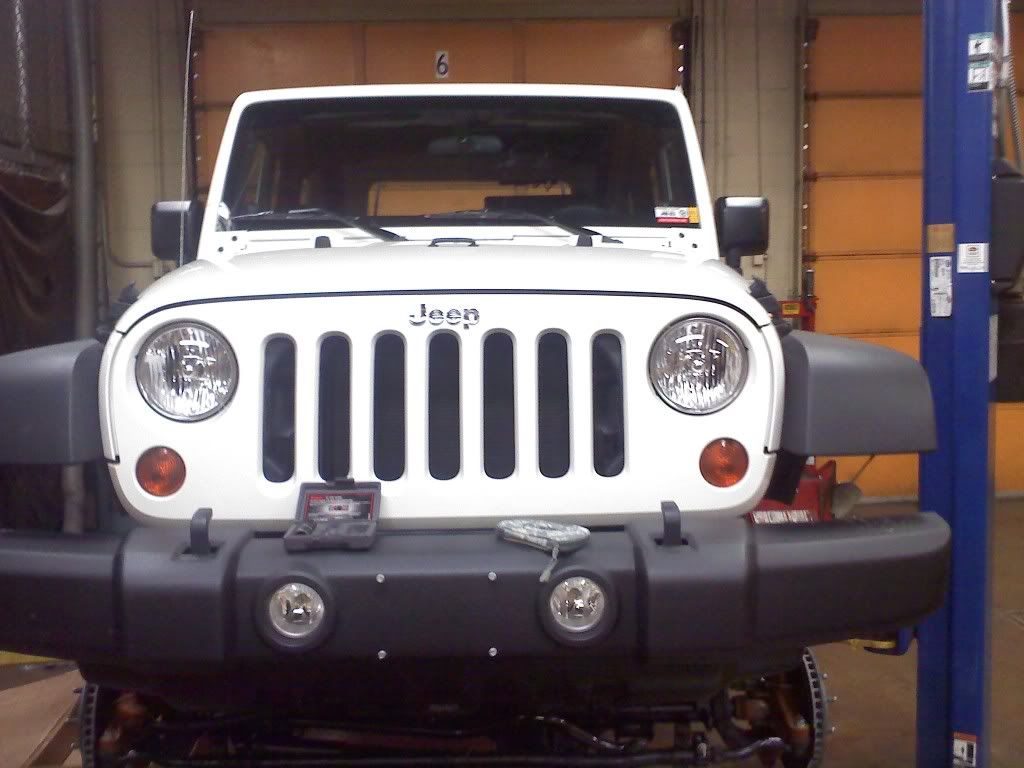

Got the front end done for the most part. Still have to reinstall the brake lines on the extended brackets and put in my dual stabilizers. Should finish up tomorrow with it all though! Update on pics

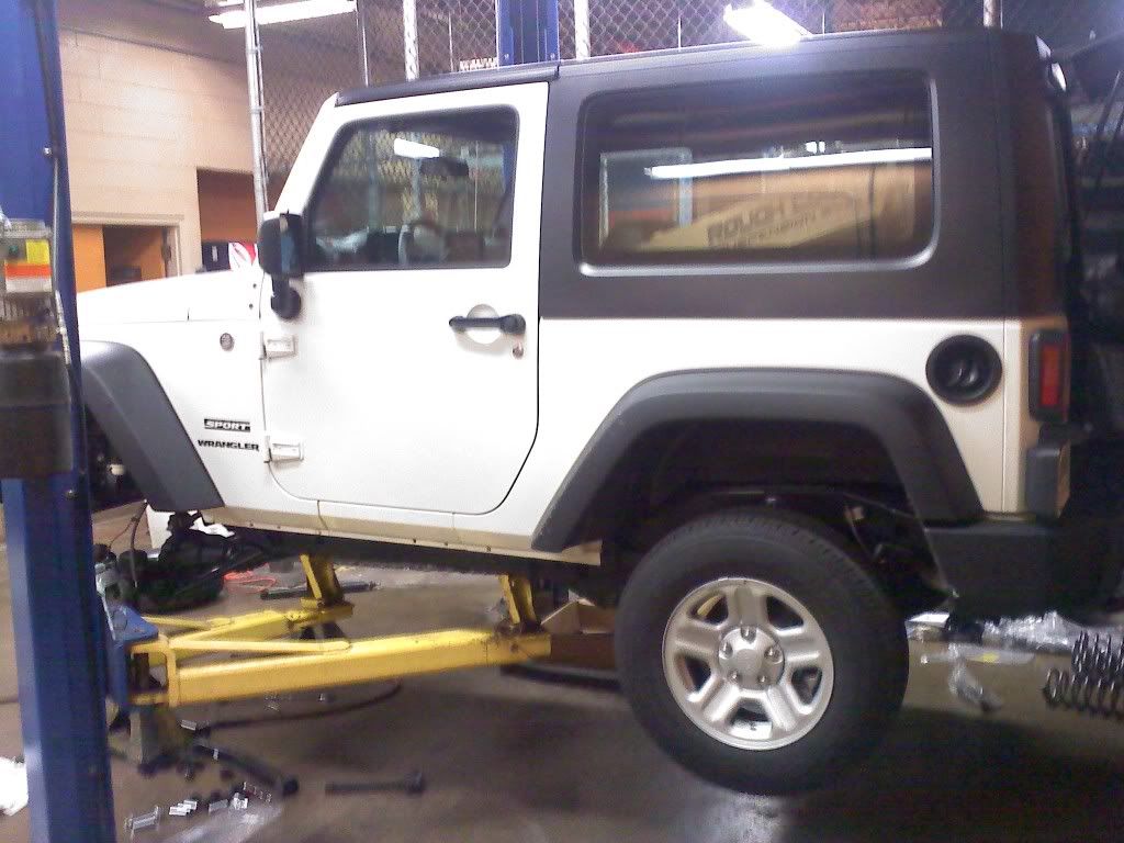

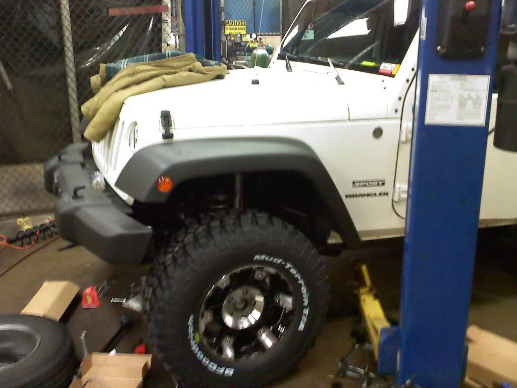

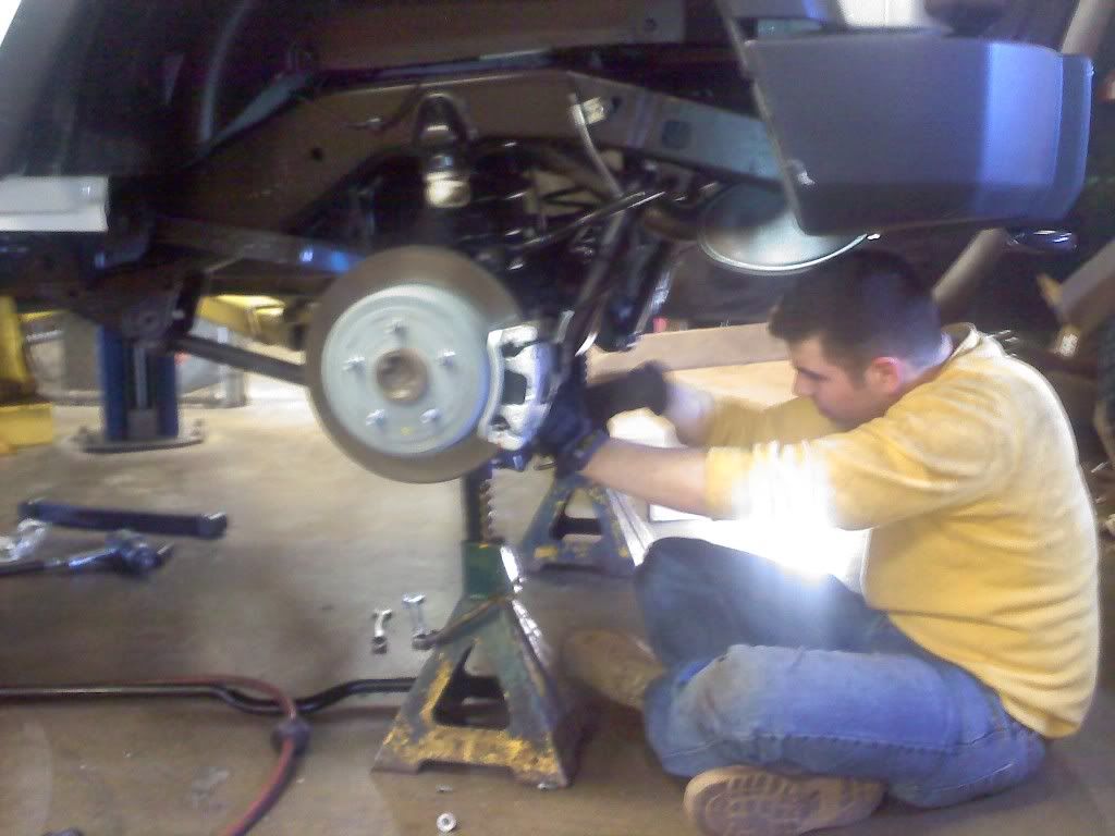

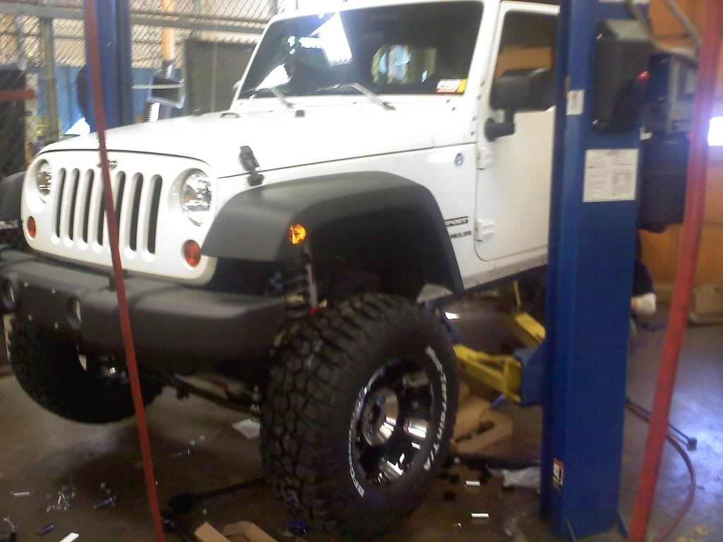

Finished putting my Lift and tires on!!! Absolutely love the kit, it rides a little rough but I expected that. Drives perfect though, absolutely no problems out of the steering! Here are some pics
Another shot of the front end

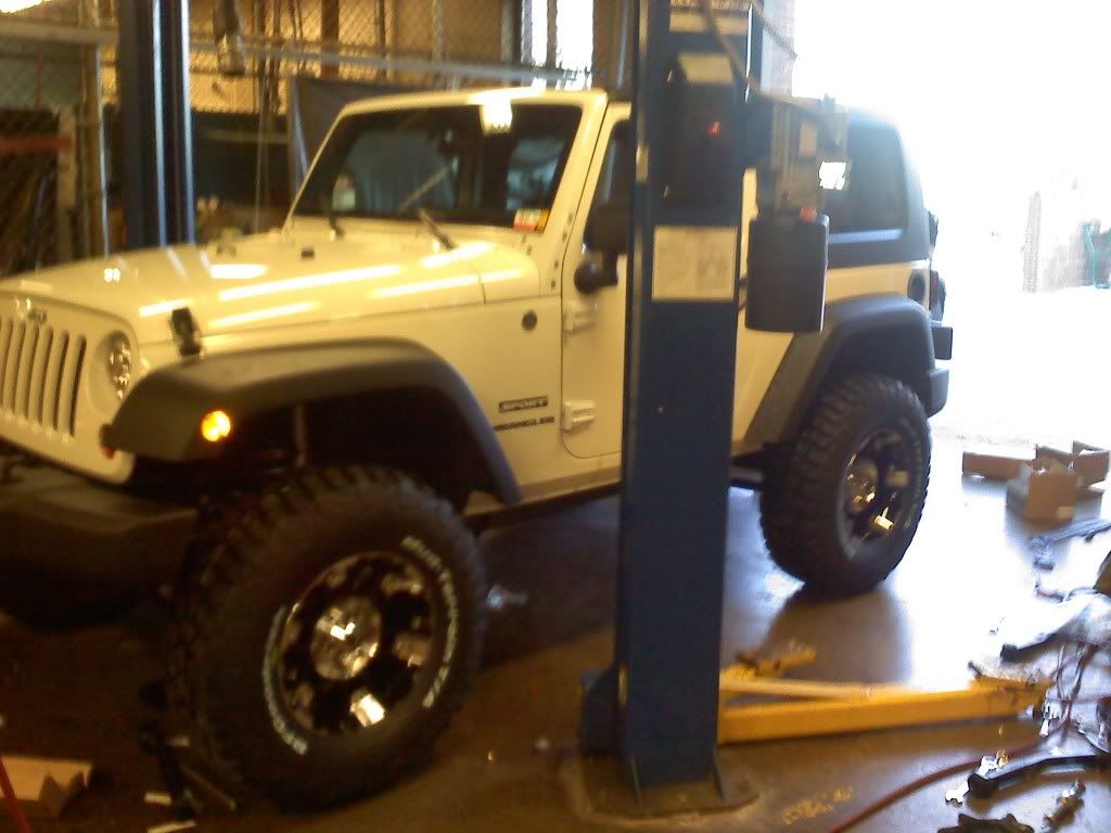

Jeep on the lift, bout to start on the rear end

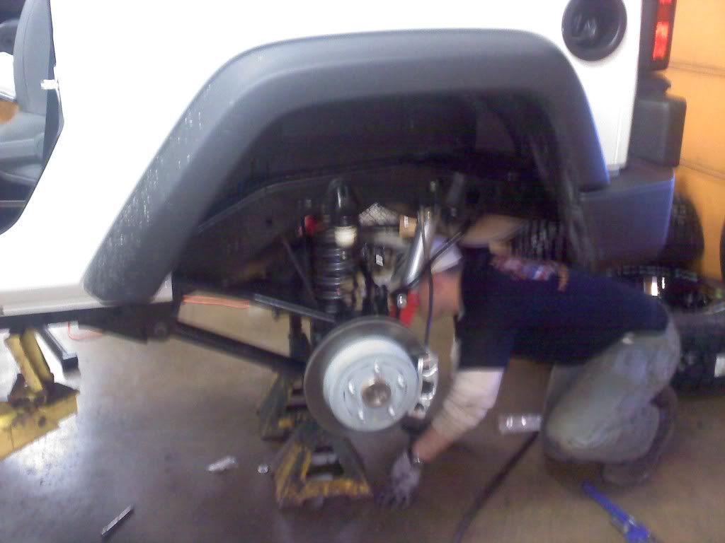

Proof that I did do the work, lol
My buddy helpin me work
Finally done!

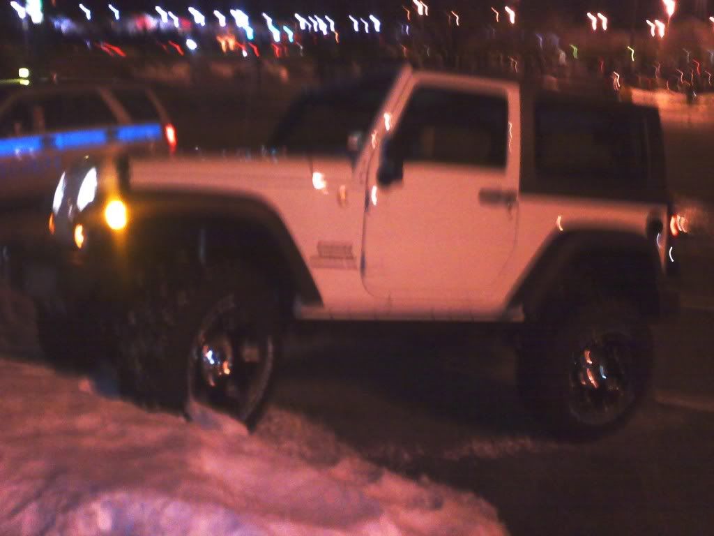

Some quick poser shots
Yes, that is a mall cop behind my jeep telling me that i need to stop. I told him i was just trying to park. lol
Me by some stockers
All said and done I got 4 inches of lift out of the front and 3 inches out of the rear. Measure 21"from center of wheel to fender at start all the way around and 25" in the front and 24" in the rear in the end. The tires with full load and pumped up to 35 psi sit at 34". Overall I love it and I love driving it.
