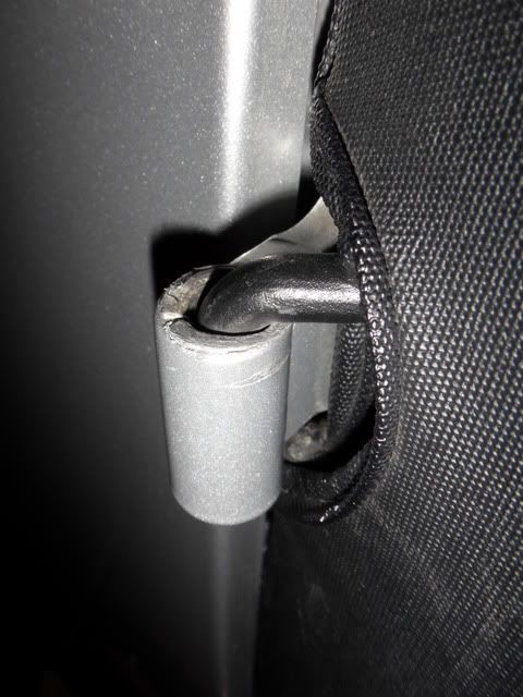

Originally Posted by cbloyer81 View Post
I think the soft-doors are going to destroy these. At least when the Teflon wears off of the factory bushings, there is metal barrier. With these it's straight to hinge paint.
Why would the be? And why more so than the hard doors?
It will wear faster because the door interfaces differently with the hinge. It basically hooks in instead of having two cylinders sitting on top of each other and evenly spreading the force.
Ah, yes! I can see that now.
But, don't underestimate the wear resistance of Delrin.
If I were to make some for the soft doors, I would make a thicker hat on the bushing, and a closer clearance on the pin.
But then, I would be committed to the soft doors all the time.
ronjenx is online now
If I were to make some for the soft doors, I would make a thicker hat on the bushing.
Yeah, I won't replace these until I put the hard doors on for winter. Then, I'll buy the black magic bushings next time. At $55 a pop every two years or so, (maybe even less $ because the back doors don't get used as often) I'm willing to support a small company and just keep replacing them.
Looks like the soft doors needs a washer tacked on there as a flange to help keep them from getting destroyed? Easy fix, I would think.

Originally Posted by Jagtec1 View Post
On my 98 Wrangler Sport, there is a definite "lip" about half way down in the hinge hole. The new bushings are about twice the length, or depth of the ones that came out. Either they are the wrong bushings, or there is a second portion of bushing that remains in the lower half both hinge holes. There is no way that the new Delrin bushings would fully seat, because of the lower half being occupied by either bushing, or smaller ID hinge hole. The bottom half cannot be easily driven out (if at all)...and I will have to continue working on it tomorrow, as I'm out of patience and daylight.
Does anyone who has installed new bushings recall the hinge hole having a "stop" about half way down (all the way to the bottom of the hole)....where the ID is about 2mm less than the upper half?
I think you're just ripping the top half of the factory bushing out. Get a scribe and jam it between the hinge and whatever you're seeing.
