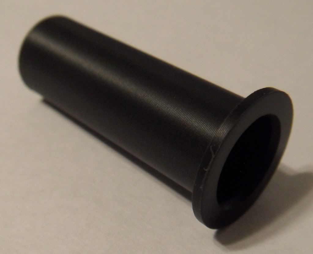

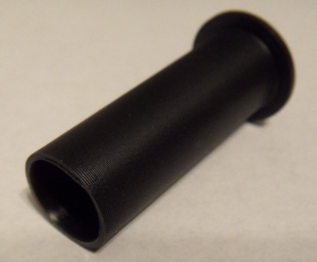

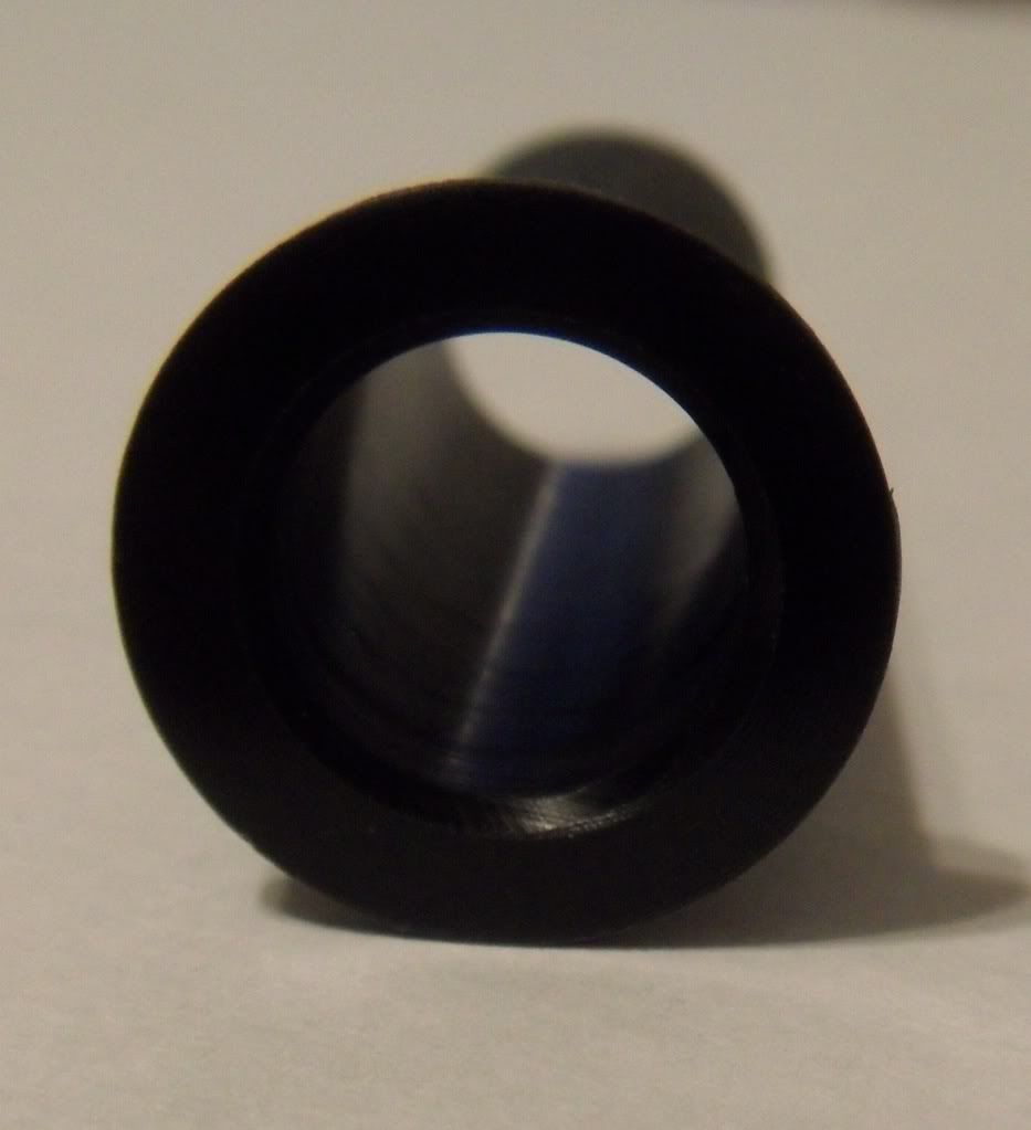

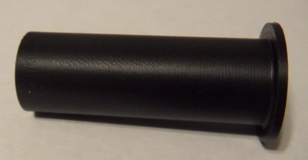

I ordered the Magnitude Engineering door hinge bushings. Fast delivery, great product / no issues.
Getting the old bushings out was hardest, as in my case they were seized in solid. There was no way to tap them out from the bottom. Then I tweaked to cutting the flanges off with a chisel, then used a screwdriver and hammer to work away at them from the top and then went pretty fast.

Delrin = self lubricating, maintenance free, super smooth. The OEM's will wear out one day so do this mod while you can still tap them out somewhat easily. I've got the Black Magic co-op bushings in my TJ hinges. Awesome describes them well.

The Black Magic door bushings are only $55.00. The magnitude engineering bushings are $79.00. Both are made out of delrin. The magnitude engineering bushings are available in white or black. The black magic bushings are only available in black.

I think the soft-doors are going to destroy these. At least when the Teflon wears off of the factory bushings, there is metal barrier. With these it's straight to hinge paint.
