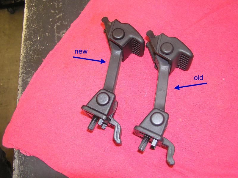

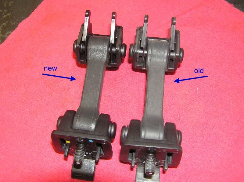

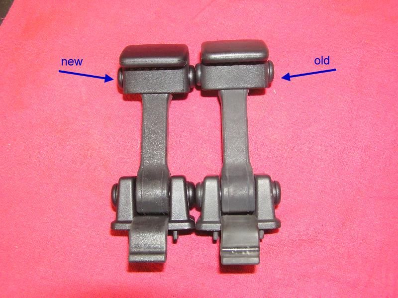

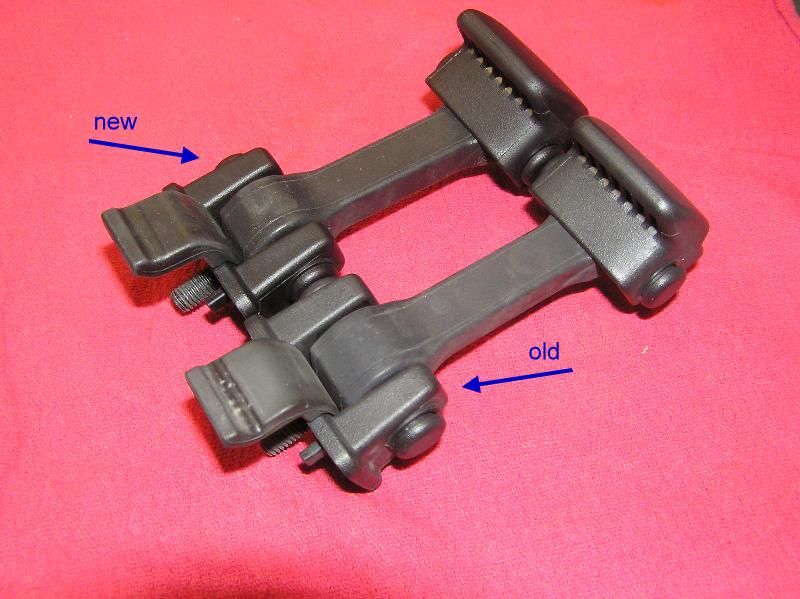

Here are the pics of the new í09 latches. They look exactly the same as the old ones.

1222, I can't disagree with you that they are harder to latch the hood. But only the first time was it really difficult for me. Now, 3 or 4 days later and they aren't easy but are ALOT easier than the first time latching them. Takes a little oomph but I have no problems latching them. Now, my fiancee probably couldn't latch it though. However, if the hood is up, it's me doing something, not her! lol
And nice pictures by the way. I'm glad it's all working out for people. I like my daystars and I think they'll get even easier to latch once they get a bit more worn in. It's only been a few days and they're already easier, so with a little more time it should be no problem I think. If they turn into a PIA, I'll just order some mopar ones! :-) I am happy with them though.
