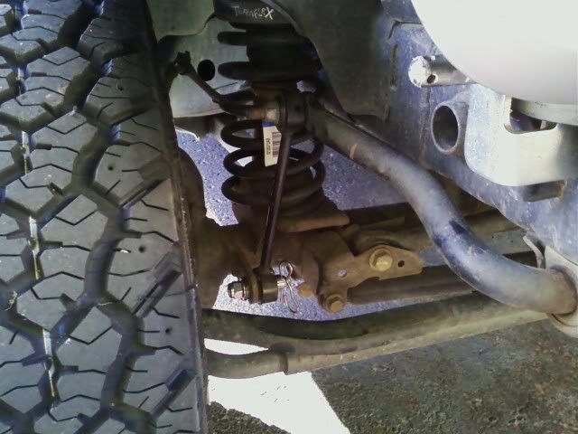

With the new swaybar links, make CERTAIN that with the top linkage, the bolt threads are facing AWAY from the tires. I tore out 2 sidewalls before I figured out that that was a crappy design on Teraflex's part. (bolts are too long! I had to cut them to make them fit the other way)
I'm happy with the kit, though, and Teraflex has been good to me.
WRONG WAY:

Thanks for the picture. Big help.
