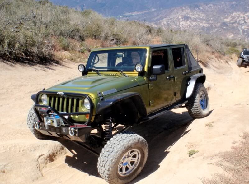

Well, for me I love my RE 4.5" long arm it handles great on road and the limited time it's spent off road it's done just fine. In Oct I'll get to test that out more, but since most of the driving I do is on road, handling well there was really important. I think most people with the RE 4.5" LA are really pleased with it too and quite a few around here have it, so hopefully they will chime in.

I run the Rubicon express 4.5 long arm kit and it works great i just go thru bushings like no tommorow
