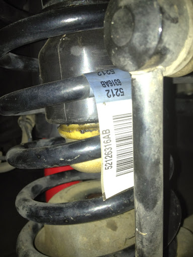

I can see all but the last 2 numbers (the ones we need) in your one picture. The coil number may help in understanding why it is sagging so much.

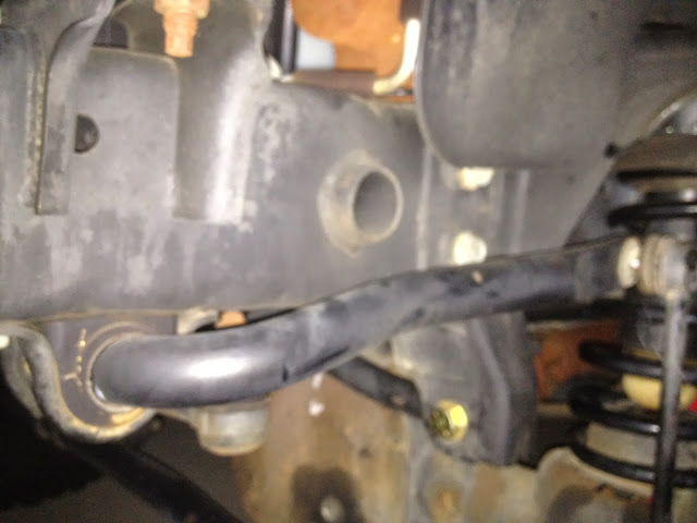

Photos showing the spring coil extension installed.
Notice how my sway bar points upward (not level) - Is this normal?
Spring part numbers.

15 and 16 front coils on a 4 door hard top Rubicon are very soft coils. My 2 door base model soft top had 13's and my 4 door Base model with a soft top had 16's on both sides. I would expect you to have 18's and at very least, 17's. Makes me wonder if someone didn't swap them out on you before you got it.
Your JK wouldn't have had too much compression to start with being a 4 door with hard top and only 15/16 front coils. Add the weight of the front bumper and a 2.75" bump stop on only a 2.5" spacer lift would explain alot of it.

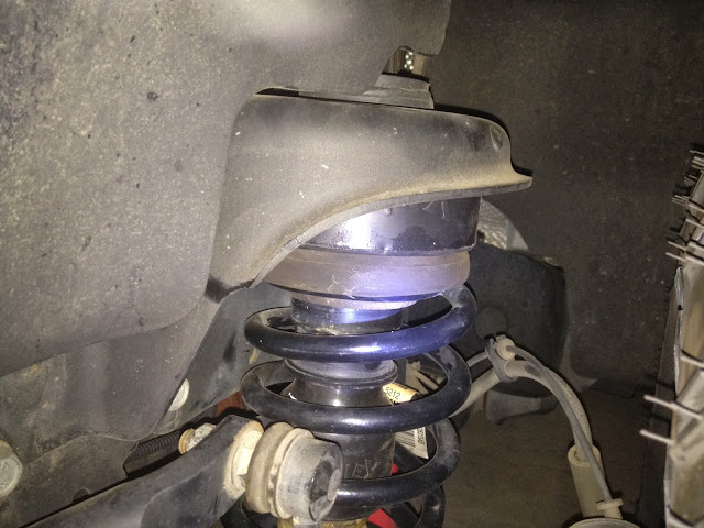

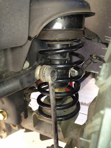

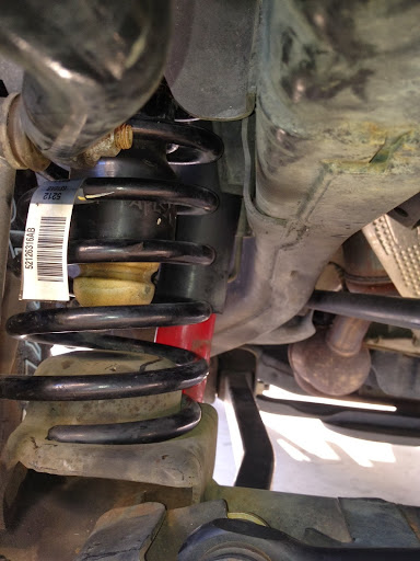

More photos.
Drivers side. Is my Teraflex extended bumpstop fully seated???
Another view of driver side.
Passenger side. Mind you there is more space between the bumpstop and axle because the Jeep is not sitting on level ground. About a 3% grade from side to side.
Another view of passenger side.
