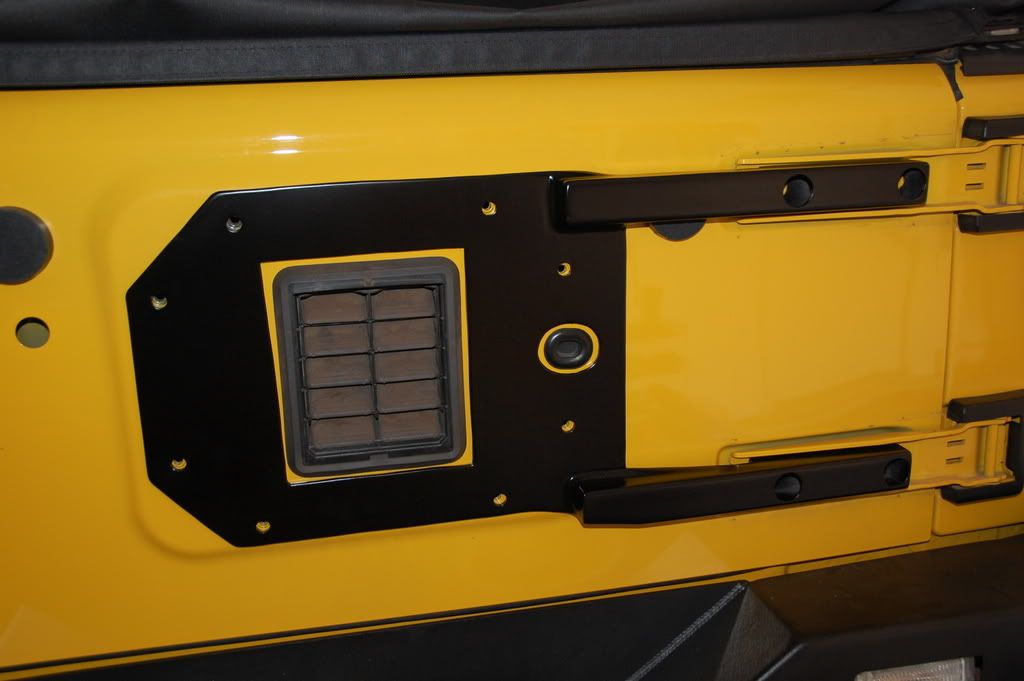

Made this support brace to tie the hinge into the tire carrier...
