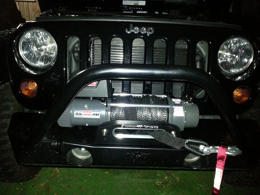

Boss , do you have more pictures of your jeep with the Teraflex 1.5 setup ? , I have a 2013 JKUR and just put a bumper and winch on the front and was now thinking about doing the leveling coils , just curious how it looks.... Here is my front end

Here are a couple that are on my phone. I have some better ones on the pc if you had something particular in mind.
