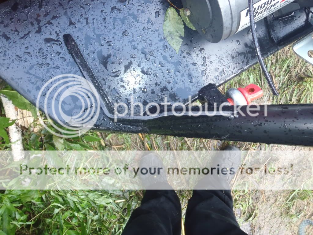

Don't fool yourself - bent gussets, cracked welds (PSC brawler lite):
Still a good bumper, but it will be much better after I have rewelded, added extra gussets, and go easier on it because I'm now off the kool-aid.
How did you bend that? Please don't reply: "I applied more pressure than the material could withstand." haha, did you use the stinger as a stinger? I'm looking for someone that's actually used a stinger the way it was intended to be used.
A felled tree...it was used as it is meant to be used, but only gusseted well enough to make it look good. Winch mount (behind brawler bar) bent about 30 * past 90...damaged a crappy Chinese winch

Molshove - surprised to see that. Went back out, and the stinger definitely looks like it is the weak link. Going to look at adding some tube from the rear of the stinger to the top rear of the bumper. Just bought a welder, so It would be nice to do something worth while with it!
That's exactly what I had in mind let me know what you end up doing!
Edit: or I can play guinea pig, being that your is still shining and mines been beat on...duh lol
