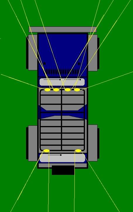

So I am getting my roof rack later this week and I ordered with it 6 light tabs, 4 for the front and 2 for the rear. First I would ideally like to have the following configuration. Sorry in advance for the ms paint mock up but it was all I could come up with!
Secondly I was curious what lights to go with. I am incredibly intrigued by the LED lights especially the Vision X Solstice S6100. They are a 6" 6 led patterned lamp that put out 2400 lumens a piece.
http://www.visionxusa.com/led/s6100/
What do you guys know about them, would you recommend them or what considerations for other options.
Thanks for your help

I would go with a set of "floods" on the back. No need for any long rang or driving beams back there. Then, definatly want a set of "long range" on the front. If it were mine, I would put 4 long range on the front. And put "driving beams on the bumper.

i have 8" kc spot in the front and i would like to add floods as well at an angle like you have in the graphic, in the back i would probably use floods. unless you drive around backwards.
i wouln't put driving lights up top you'll just light up your hood.

The Solstice is essentially a 500w light, but don't get the 6100 euro pattern up that high. The 6102 has more of a spot beam pattern.
You should also look at the 4100 series. Those are closer to a 300w, and a lot less money.

Hmmmm interesting. I may go with 6100 spots on the 2 center mounts up front and 2 4100 floods for the sides and rears.
Do you have any pics of your current setup? How bout pics and specs on the Hellas. If they are cheap enough I could be persuaded to change my plans!
