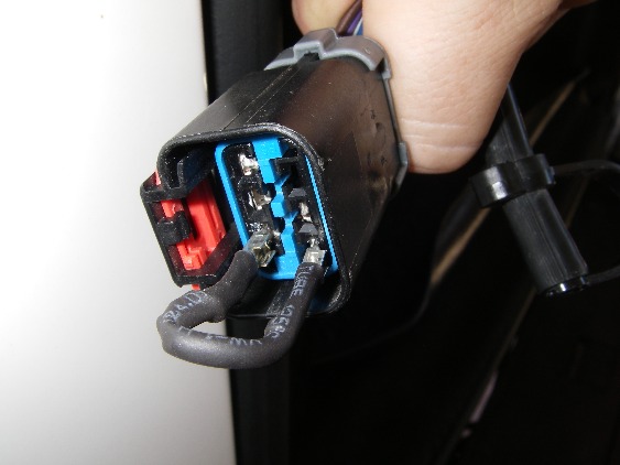

I've seen several references in this forum to volume limiters enabled on JKs without a hard top installed. I'm familiar with the threads of even 'jumping' the hard top harness to trick the system into thinking a hard top is present. For those of us especially with soft tops-only (and no hard top harness), has anyone truly identified how/where the sound bar and rear sub speakers are getting 'dummied-down'? The dash speakers appear much louder (than the same speakers in the sound bar).
I really want to retain my 730n + connectivity package - so I'd like to figure out how to unleash more sound without having to roto-rooter my entire system. I just ordered 4 new 6.5" speakers (for dash and sound bar) - thanks to the suggestions by several of you. I see that there's also a Plug-n-play kicker upgrade/replacement amp.... Would that bypass the limiter?

When you have the factory hard top, there is a harness that is included (power to the interior lights, rear defost, rear wiper, ect) in the rear of the Jeep....it plugs into the hard top and would assume, completes a circuit. That is how "jumping the harness" works.

Have you tried a jumper? It take 10 seconds to try.
What we don't know is why it works for some but not for others.
I used to have mine jumped, but I pulled my jumper...mostly because I'm worried that I'll somehow hit my rear windshield wiper fluid switch and soak the back of my Jeep.

My 2013 2 door rubi is louder when the hard top wiring is unplugged.I guess mine is a oddball.I mentioned this before on another thread and only one other person said theres did the same thing.

There's a massive thread from about a month ago with dozens of people trying the jumper thing and noticing a difference.

ok ok....i found this on you tube..... i guess your right
u can hear the diffrence when he plugs and unplugs it. why would the volume be limited when the hardtop is removed? saftey wise- shouldnt it be the opposite?
