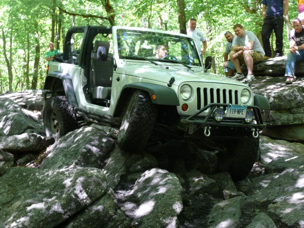

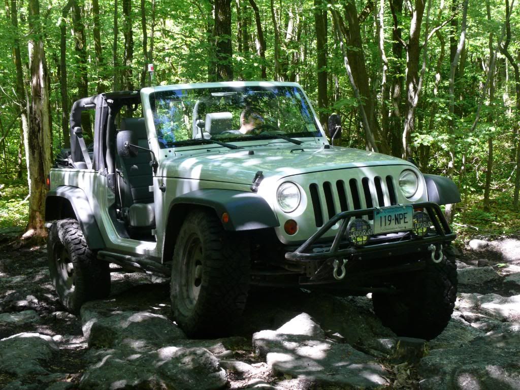

Not the best pics of my trimmed flares but you get the idea. I did a very mild chop, just enough to clear my 33's at full flex. I used 1.5" painters tape to mark how much I wanted to cut off, used a set of tin snips to cut the fenders themselves and cut the inner fenders with a razor knife. The whole process was very straightforward, once you start tearing everything apart it's very easy to see where to cut. Finished of the edges with some black door edge trim that's available at most auto part stores. I will be installing full tube fenders in the future, when I make the jump to 35's...but for the time being the chopped stockers work great.
